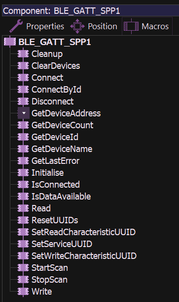

For PC developer, this afternoon I've written a DLL to interface the Windows Bluetooth API (will need at least Win10 for this to work) and I've written a component to go around this. Just need to test it all works now. Hopefully later today or tomorrow we will have something I can share.

Right this is largely working for me now but it needs more work to make it a bit more user friendly in terms of the usual read/write functions.
First you need the DLL which needs to be extracted and placed here:
C:\Program Files (x86)\Flowcode v11\API.DLL folder.
BLE_SPP_DLL.zip
(101.93 KiB) Downloaded 448 times
Next you need the BLE component. Here is the exported component file that needs to live here:
C:\ProgramData\MatrixTSL\FlowcodeV11\Components
BLE_GATT_SPP.fcpx
(3.05 KiB) Downloaded 454 times
Lastly here is the component source code, it has a little code in the main as a basic test I've been trying out.
BLE GATT SPP.fcpcd
(44.2 KiB) Downloaded 466 times
Let me know how you get on.

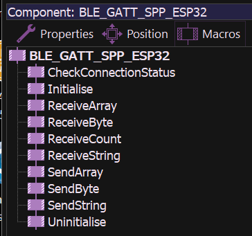

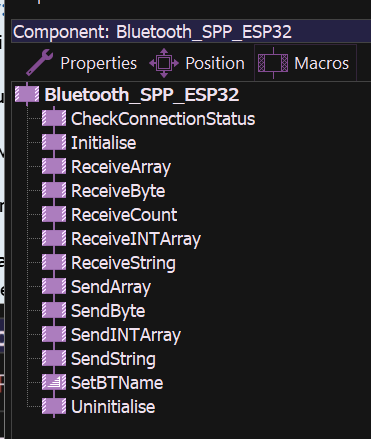

I can already work with read and write buffers, but it would be nice if BLE ESP32 and BLE App could read/write in the same style. I mean read/write string, byte, array, int array :) that would be easier for me and others.
Here is an example from the ESP32 SPP.
for comparison:
