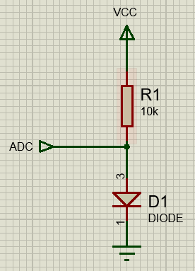

If you have a spare ADC pin then the easy way is to connect the ADC pin to something like this.
The diode will have a specific forward voltage drop across it, usually around 0.7V for a standard diode and more like 0.45V for a schottky. As your VCC drops the ADC reading will rise allowing you to calculate the value of VCC.
Assuming a 10-bit ADC and a 0.7V diode. ADC resolution is ((1 << 10) - 1) = 1023
A fixed voltage reference would be better then a diode but in a pinch a diode will work.
Note there is some variation of the forward voltage drop across a diode with temperature, hence why the diode isn't ideal. The resistor value doesn't really matter just keep it over 10K to reduce current usage.
If your device has an internal reference then it may be fairly simple to use this instead to do the same thing.
VCC Voltage = (0.7 / FLOAT ADC Reading) * 1023.0Note there is some variation of the forward voltage drop across a diode with temperature, hence why the diode isn't ideal. The resistor value doesn't really matter just keep it over 10K to reduce current usage.
