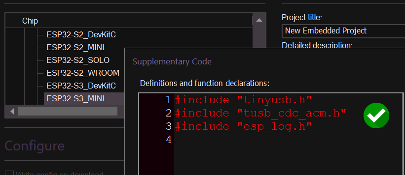

I've now updated to 5.3.1 and added the USB Tiny dependency.
I also have some C code there can I use it in Flowcode?
include are ok:
#include "tinyusb.h"
#include "tusb_cdc_acm.h"
#include "esp_log.h"

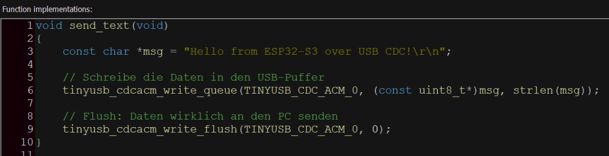

Yes - you can use the C to initialise - rename (app_main) initialise (or some such) and add a function definition to the 'includes' (top) box of supplementary code... ( void initialise(void); ) Remove the loop (and the 'hello world'?) from the end of the function...
Then call initialise(); from a C block.
You can also add a 'Print(char *str);' function - which could call tusb_cdc_acm_write and flush..

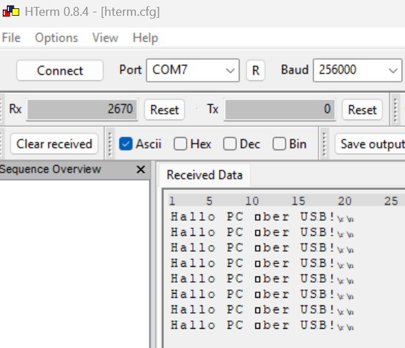

Thank you Martin I'll give that a try.

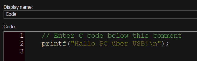

I've had a bit of success with `print_F` so far.
I still have no idea how to send an array
Very short program:
Post_esp531_1.fcfx
(9.77 KiB) Downloaded 493 times
C-Code:
On computer (regardless of the baud rate)

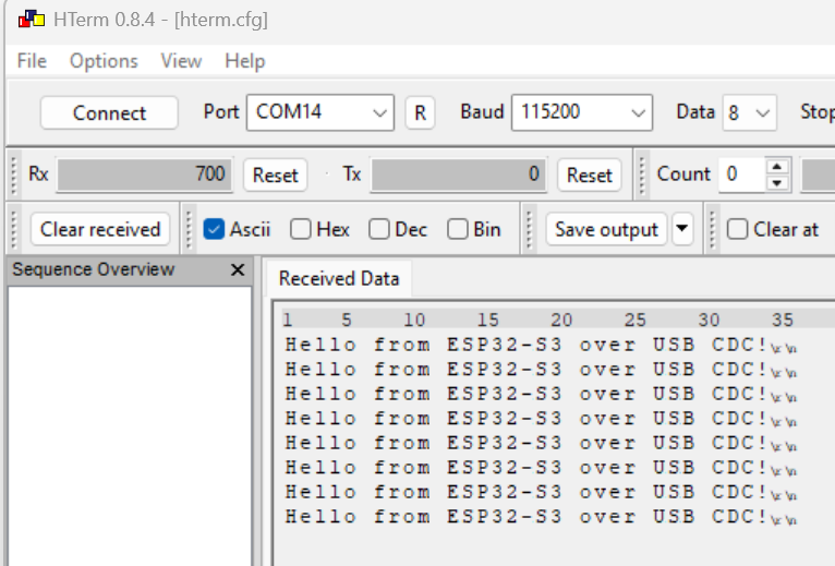

Hi Martin

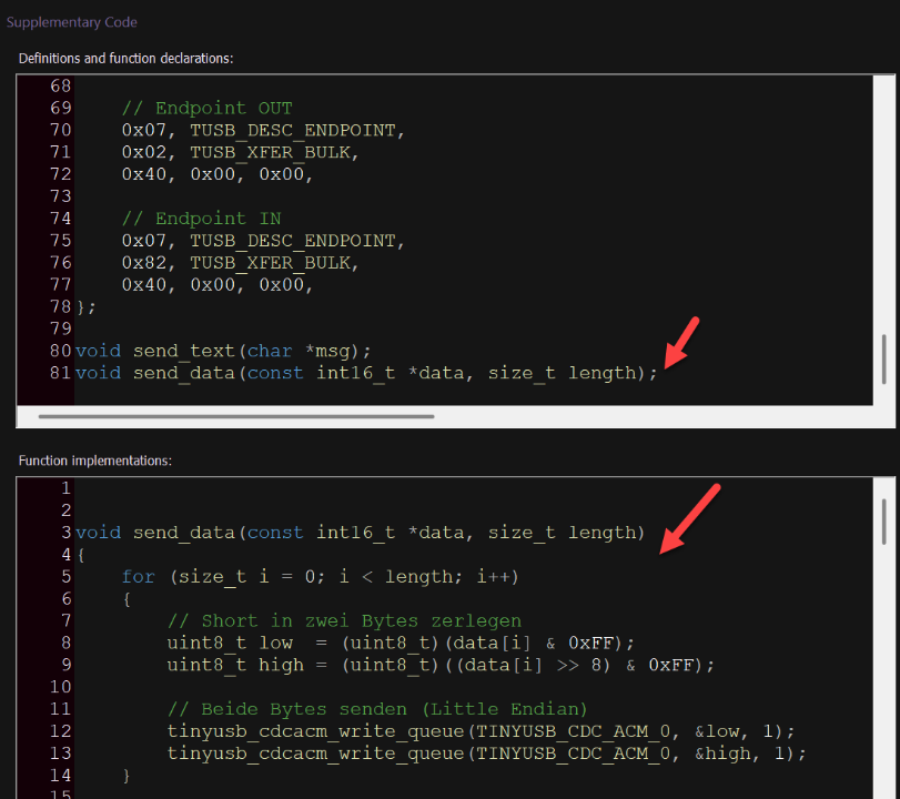

Your suggestion works perfectly!
I had to make a few adjustments. Sending is done using the function in the additional code. How can I send an array from my program? I'm not sure exactly where I need to add FCV_.
Post_esp531_3.fcfx
(13.91 KiB) Downloaded 447 times

Hi Stefan,
Something like this?
Post_esp531_3.fcfx
(12.4 KiB) Downloaded 437 times

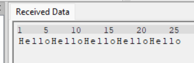

I expanded your example to include an array for sending data, and it works.
I can also receive the binary data array very easily using the Flowcode APP Developer. :)
Demo:
Post_esp531_4.fcfx
