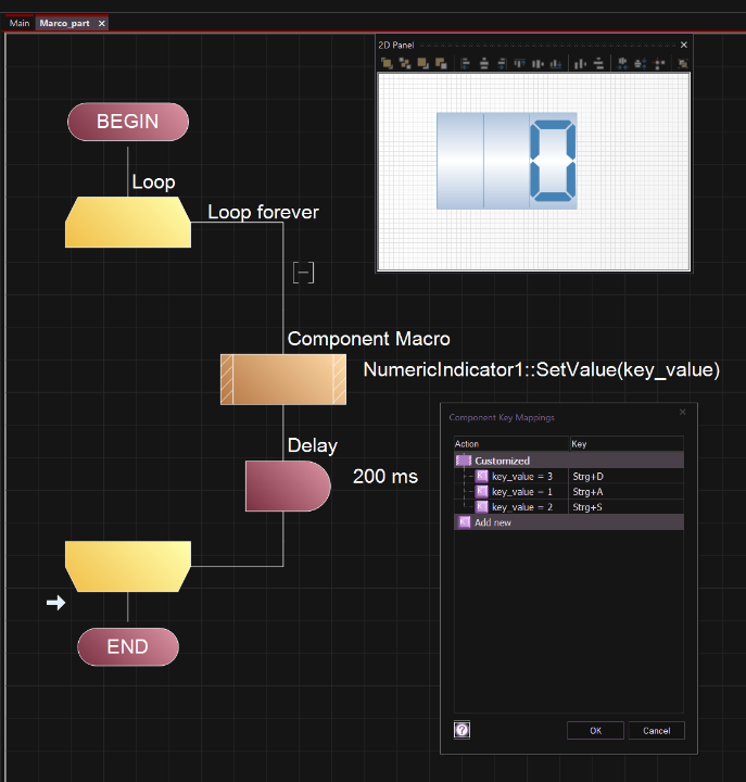

One more question:
Does the keymap only work in the main part from the APP?
It doesn't work in a macro.
One more question:

Re: Appdeveloper: use a short key?
It looks like you need to have the Simulation Speed (in the Simulation Debugger window) set to "Fast (with updates)".
This is part of Flowcode that has not been looked at in a very long time, so I will add it to our list to investigate and see if we can have this working better.
Hi Steve
Ok in the simulation it's working, if I set max speed and stepp in macros.
But in the exported APP, it's only working in the main and not in the macro.
The good thing is:
In the exported APP, the keys works in the main perfect!
The good thing is:
