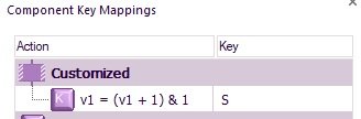

For PC developer you can use Key Mappings available from the Edit menu.
You can assign a calculation to a keypress, for example I have this to toggle a variable on and off when the S key is pressed.
You can monitor for this variable changing by having a decision in your main loop checking if the variable is equal to the old value.
It works fine for the PC developer source and for the export.

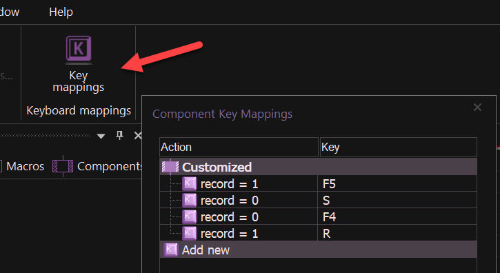

Perfect!
I add key mapping and use the switch with call macro if click (OnButtonClick). This works very well.
Only the switch doesn't have such a good 3D effect. :)
short key and switch works nice together.

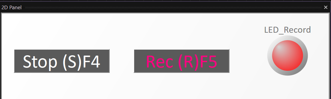

switch and led:
KeyMappingsDemo3.fcpcd
(14.47 KiB) Downloaded 250 times
