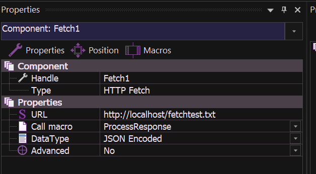

I've edited your files to show how this could happen.

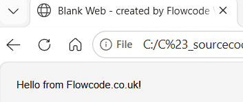

Some changes I made to the Web Developer app:
  • The DataType is now JSON Encoded
  • The URL is a local IP address as created by the PC Developer app's Network Comms IP Address
  • The ProcessResponse macro extracts the "Data" tag from the received JSON packet
Some changes I made to the PC Developer app:
  • Removed the File I/O component
  • Changed the HTML source to Embedded
  • Added a custom header for CORS and JSON
  • Added the "fetchtest.txt" file with a JSON string

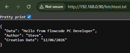

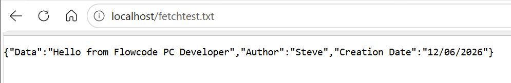

You can test to see if the PC Developer web server is active by opening page the following in a browser:
http://192.168.0.90/fetchtest.txt
It should report the JSON string.
The IP address is likely to be different and is the one specified by the Network Comms IP Address property.
Here are some images showing it working:
PC Developer webserver test.png (14.09 KiB) Viewed 10562 times
Web Developer app.png (10.4 KiB) Viewed 10562 times

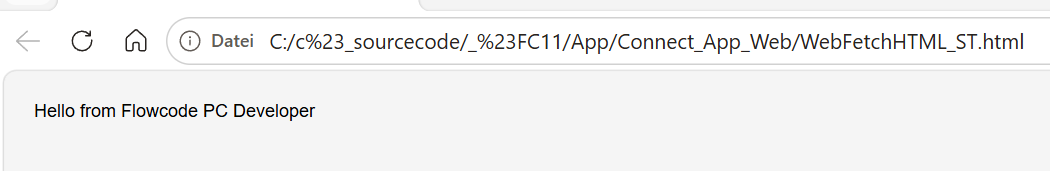

Hi Steve
Perfect!
I can use “localhost” instead of the IP address, so I won't have to make any adjustments if it runs on a different computer
And the result from the Web App:
So, connecting the Web App to the PC App is very easy and user-friendly.

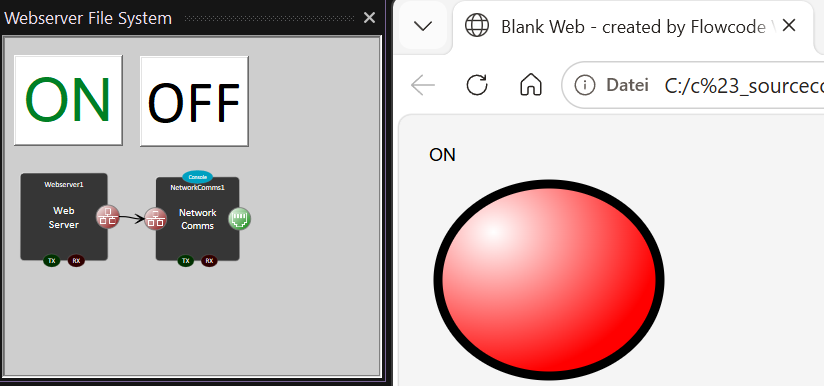

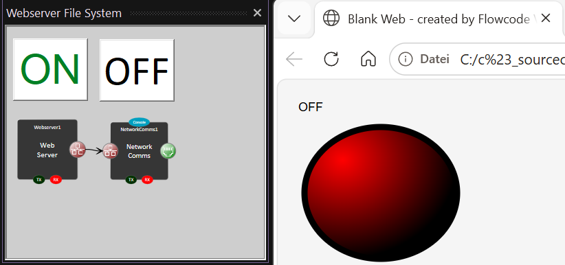

Hi Steve
With your example, polling every 500 milliseconds works very well.
I can simply use a button in the PC-App to set a state (Ledon on/off) in the Web App
