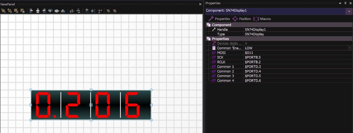

A simple display (4 digit) using a shift register.
A couple of points:
1) Pull the OE (output enable) pin to ground either in code or in hardware.
2) Multiplex needs to be called regularly - ideally use an interrupt - as per demo. However it could be called in a loop (with a delay). Something like 240Hz is ideal. Setting up a timer interrupt for each MCU is slightly tricky - so left to the user here.
3) Multiplex bit-bangs the data to the shift register. I tested on an Arduino (16MHz) - there is a a chance that some MCUs might be too fast - add some 1uS delays (in the code but disabled here) I've not tested this - it might cause issues on some MCUs (esp32) depending on how the delay is implemented in FC.
4) The display needs to be connected to the shift register segment A to Qa - B to Qb etc with dp to Qh. Assuming standard segment layout. For common cathode the component inverts the data - not tested (I don't have any displays like this) - polarity can be set in properties.
The Display macro takes a decimal point position - and attempts to 'pad' with 0s rather than have leading spaces (so 0.001 not "0. 1" or " . 1")
Negative numbers are not handled (nor the possible 7 seg character set (A, B, C, E, H, L etc)))

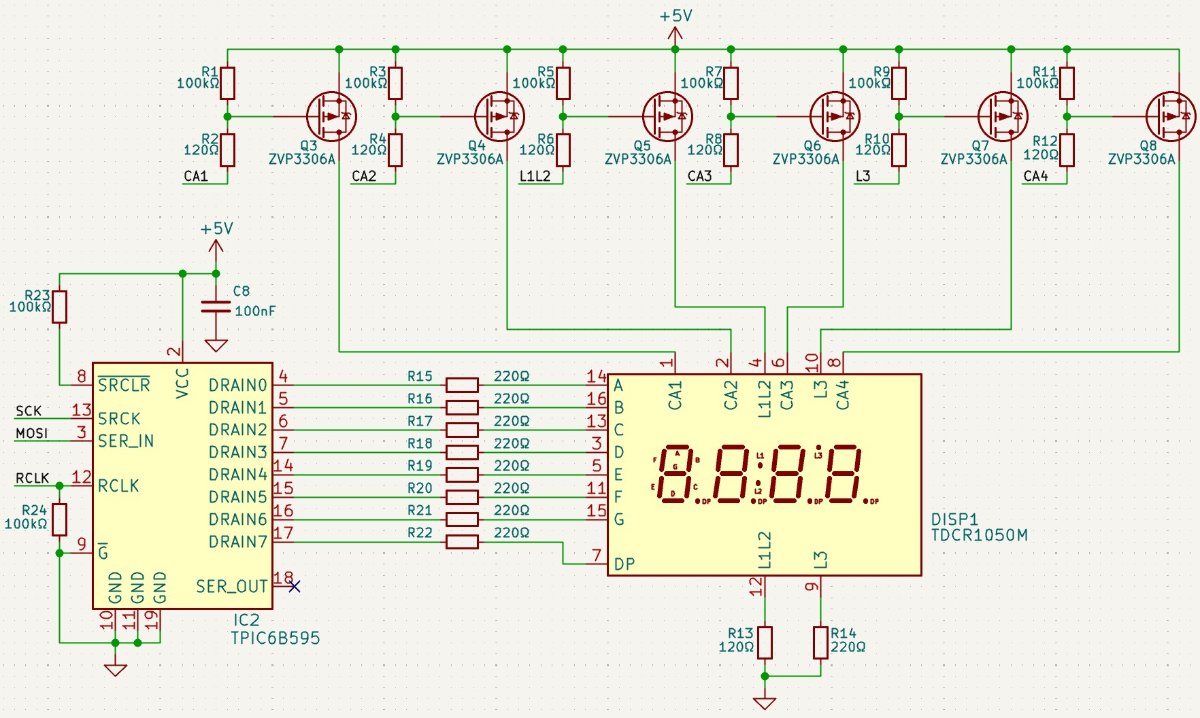

Here is the schematic that depicts the FC component I need:

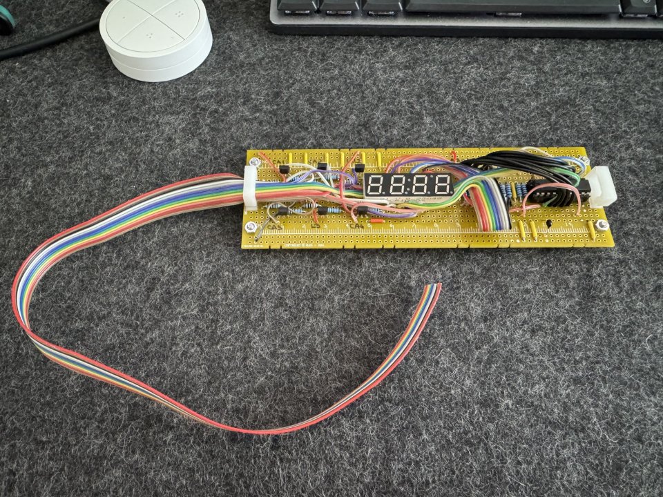

Here is the prototype that I've built with TPIC6B595:
I have ordered two hats for the Arduino Uno and Mega from Mouser with Wago connectors, so I can work with the wires more easily:
https://www.mouser.se/ProductDetail/426-DFR0920
https://www.mouser.se/ProductDetail/426-DFR0921
I should be able to test this prototype within 1-2 weeks if I have time, and I will provide more feedback on the component you built for me.
Andreas

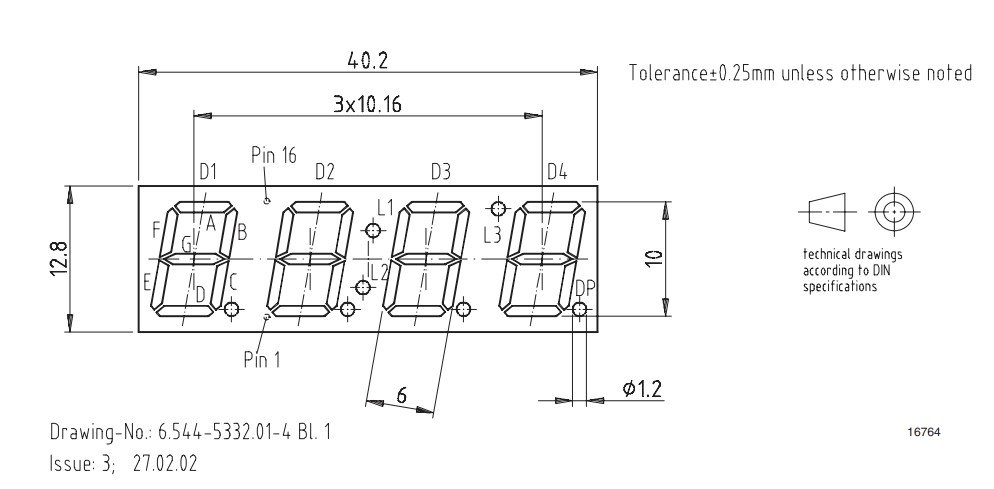

Would it be possible for you to make some cosmetic changes to the component and, for simulation purposes, add pins for L1L2 and L3? I am using all of them in my project, including DP, which is common to all four CA1-CA4. I know I can use LEDs, but I want a nicer display that includes everything.
Right now, the display component looks as follows:
What I would suggest is to overlay the display from the datasheet of the TDC.1050 and make a whole display that depicts the exact angles, L1L2, L3 and DP placements.
Eventually, if it's someone from Matrix TSL who's interested in this component, I can send it from Sweden to the UK for additional testing, and with my request to add it to Flowcode as a component, specifically for pairing with TPIC6B595.
Andreas
tdcx10x0m.pdf
(240.22 KiB) Downloaded 120 times

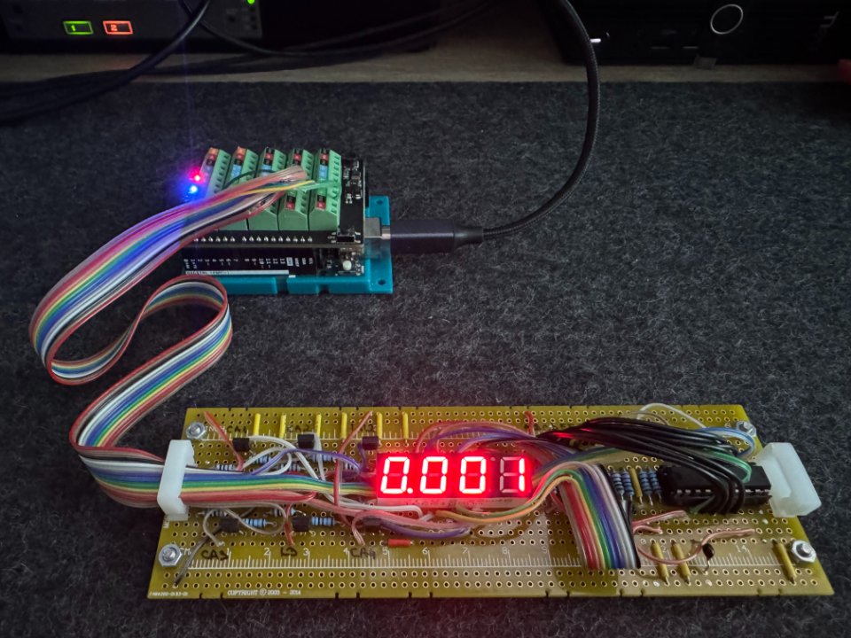

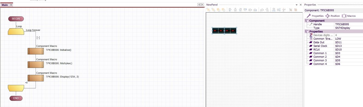

I have managed to wire the display board, and it all works fine:
Unfortunately, I cannot figure out how to display digits on the enclosed TPIC6B595 component, which I placed on C:\ProgramData\MatrixTSL\FlowcodeV11\Components:
TPIC6B595.fcpx
(2.94 KiB) Downloaded 86 times
Let's start with the string 1234... How do I do it?
Andreas

Post by andeug »
I found it! Your component works great! :D
The flow code below allows me to display 12.34:

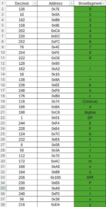

Now, if I want to display characters like "h", "n", "o", is there any way I can do it by telling each digit that I need a hexadecimal value? I need a separate ShowDigit macro that can display the characters of the alphabet and control each DP.
Basically, I need to define a list of numbers and constants for the entire alphabet, and then pick the letters that can be drawn on a 7-segment display as hexadecimal values.

It would take a little work to change the component - it needs to use the larger lookup table of character data and would need a 'DisplayStr' macro or similar?
Try not to make a fixed lookup table, because I will define each character in a hex value from 1 to 256, and they will become Constants in my code.
This is useful for someone who respects the wiring and knows what kind of letters will be there. But, for example, I have the Mikroe 7seg Click, where some wires are reversed and do not follow a standard. Therefore, I've had to test each address manually and see what I will get on the display, and here is the result:
Multiplex might/would need to be altered to access the extra characters depending on how you want to create the displayed values?
I only need a field to enter the values between 1 and 256, as in the upper value, and get something. I need to be able to tell the value and the column (ideally, it would be if you could make a display configurable between 1-8 segments).
Another option would be just to modify multiplex and pass an array of 'segment values' (each a byte) and pass this to it instead?
Maybe this is similar to what I did earlier in my Excel table? (I have experience with electronics, but not with coding, so I don't know if we are talking about the same) :roll:

I don't quite follow your table - if, for example, I want to display '1' - I need to find the segment pattern for this. There are several ways to do this - but a a lookup table (an array or a LUT) is quick and linear time.
so .segs = lookup[1] ? Or if using ASCII .segs = lookup['1' - '0'] (lookup contains data for digits 0..9)
Multiplex needs to know what segments to display (so each digit is made up of 1 byte (8 bits) - where each bit corresponds to one segment) - this might be better served with 'display_data[4]' holding the segment data for each of the characters in the display and Multiplex using this?- and the DisplayTime(str) - macro can lookup / calculate the required segments.
As an alternative - if the lookup is in RAM then a SetCharacterSet(data) macro could be used?
