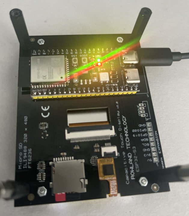

I'm not exactly sure what I'm doing wrong.
It worked with the ESP32-wroom. With the ESP32-S3,
I can't get it to work. I've already tried three different boards.
I also noticed that the green LED is flashing.
That happened with the SparkFun board, too.

I wonder if the LED is interfering with the signal e.g. adding capacitance and stopping the signal from running at full speed? Maybe worth removing it?
Aha I didn't know you were using my board ok I'll see if I can replicate the issue there for you and let you know. It's slightly different to the Matrix version and so there could be something minor that's causing it.

This is a very practical board and works well as a data logger if there is enough space and power available.
The SD card is also located in an easily accessible place and wired in 4-bit mode.
There is just one issue with initializing the card.

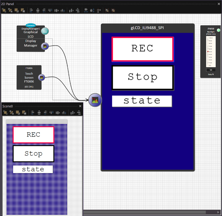

I got the touchscreen working. It's very easy to use. It's simple to start and stop a recording using the large touch fields.
unfortunately...

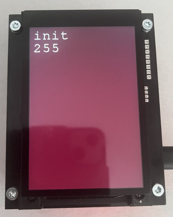

I'm still having problems with the SD card—it won't initialize.
CapTouchTFT_ONE_touch_rec_macro_.fcfx

There is a problem if I try and initialise the card multiple times, it works the first time but then returns 255 every time after that. If I uninitialise the card as part of the loop then I can init over and over again and always get a return value of 0.

And... You're right if the card send once 0 for ok you can not init again. You need to uninit first.
I tested with the stop button to uninit b4 I init again.I will include this into every sd-init loop.

Is the `dc_touched` macro not an interrupt but a "normal" macro where everything is allowed and works?
Posts: 2332
Has thanked: 647 times
Been thanked: 856 times
Re: ESP32S3 SD-card init problem
DC_Touched is called from the DisplayManager1::CheckForTouch call.
It's not an interrupt, you can put what you want in there but I would maybe treat it somewhat like an interrupt in that you essentially block the UI while you're in there.
