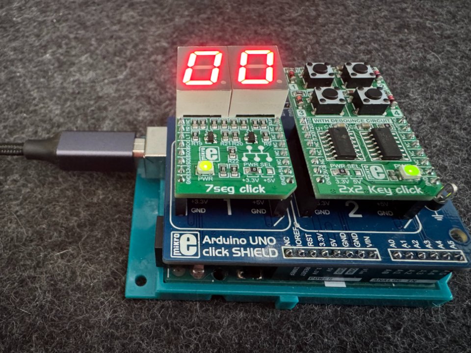

You can't imagine how much I've been struggling all day trying to make this work, and I haven't managed to yet. Thank you!
One thing that does not work as expected is that you have to press the buttons slowly, and the counter does not respond to quick presses (not sure why - maybe some delays must be added somewhere?).
I have loaded your code on my hardware, and it has worked from the first try:
