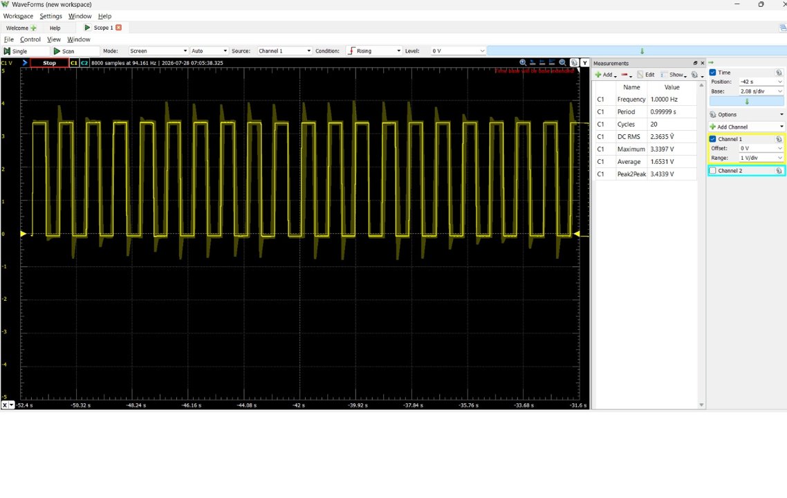

Hi Steve,
I have just performed the 1-second LED blinking test exactly as you suggested, embedding it directly into the main application loop. To provide absolute proof, I monitored the pin behavior using an oscilloscope.
I am attaching the screenshot of the waveform measurement below, which shows:
Frequency: Exactly 1.0000 Hz
Period: Exactly 0.99999 s
These physical measurements definitively confirm two critical facts:
1 - The clock configuration is 100% correct: Flowcode's internal timing calculation aligns perfectly with the actual physical execution speed of the PIC32MX795F512L.
2 - The MCU does not freeze or lock up: The code executes and loops flawlessly without any physical crash or software hang, even after the SSD1963 initialization macro runs.
The program remains fully responsive, yet the display panel simply stays completely blank. Since the timing, hardware, and connection properties are now verified to be correct, what would be the best next step to investigate why the component is not initializing the display properly?
