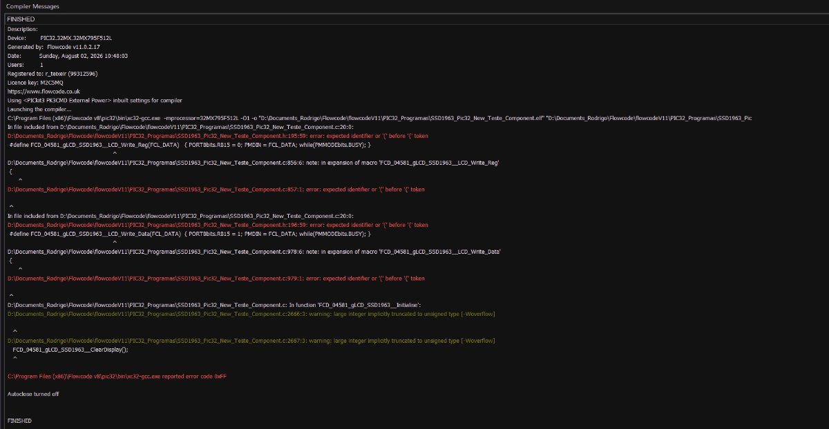

I am attaching the screenshot of the compiler messages. Could you please check if the SSD1963 component C template needs an update or a data type casting fix for the PIC32 toolchain?

Following up on my previous post, I have spent the last few days trying to bypass this limitation by developing a custom component and testing different approaches, but unfortunately, there has been no success in getting the physical display to work.
The breakdown of my tests clearly proves that Flowcode 11 is blocking my custom C code from overwriting the native bit-banging routines. I proved this by analyzing two distinct scenarios:
Scenario 1: Using only my custom component (WITHOUT Supplementary Code)
The custom component was built using "Expose to top level" on the three main macros (Initialise, LCD_Write_Reg, LCD_Write_Data), replacing their contents with custom C code targeting the physical PMP registers (PORTBbits.RB15, PMDIN, etc.). It was exported with a new GUID, macros set to "Downloadable", and "Use supplementary header code" enabled.
- Result: The simulation/animation works perfectly on the PC screen. The compilation to target also finishes successfully and generates the hexadecimal file. HOWEVER, nothing happens on the real hardware. When checking the generated .c file, I discovered that Flowcode completely ignored my custom C code and forced the generation of the default software bit-banging routines (SET_PORT_PIN sequences) at the bottom of the file anyway.
Scenario 2: Trying to bypass the limitation (WITH Supplementary Code)
To stop Flowcode from using the bit-banging routines, I tried adding macro #define steering directives or re-declarations inside the application's "Supplementary Code" window.
- Result: The simulation still works fine, but the compilation to target completely crashes, failing to generate the hexadecimal file. The XC32 compiler returns error code 0xFF (error: expected identifier or '(' before '{' token or error: redefinition). This happens because Flowcode insists on generating the native function signatures further down the file, causing a direct syntax collision with my supplementary C code.
Conclusion: In all scenarios, it is proven that the custom register-level code cannot overwrite the native component's bit-banging routines. Either Flowcode forces the bit-banging silently into the .hex (Scenario 1), or it causes a compilation collision when I try to override it (Scenario 2).
Since I am just trying to compile a simple "Hello World" application and the software structure is preventing me from using the required hardware PMP bus, what is the official way to force Flowcode 11 to completely drop or ignore the native bit-banging routines so my custom C code can take over?
If you need anything alse let me know

I tested this - I modified your component (slightly - gave it a new GUID changed the name) and compiled to SSD_TEST - then compiled the test program having modified it to use the new component and removed the old component. The new component moved to development - with name SSD_TEST
Have no way of testing on hardware - but it should use the write routines in your code.
