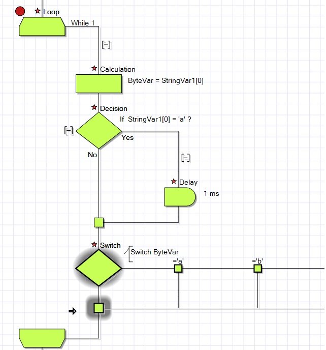

Re: Question regarding the switch function, and a thought
Would the attached example work for you?
You can use single string chars for the switch function.
Using string for switch function.fcfx
(11.6 KiB) Downloaded 283 times
Post by alanwms »
The attached helped but - - I can get the if block to work but my switch simply falls through
Posts: 2479
Has thanked: 795 times
Been thanked: 858 times
You will required something on each of the Switch function branches to determine if code is working or not.
If you post your fcfx project file, I can have a look at it for you
