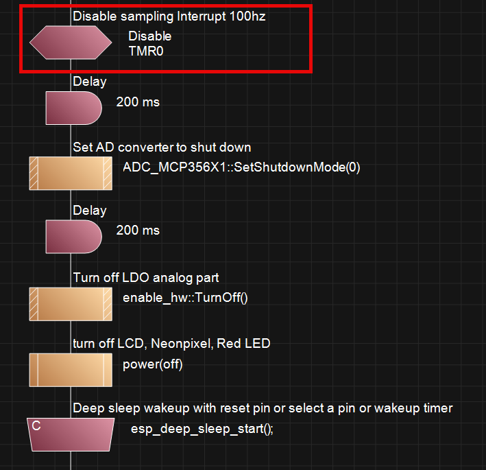

With a very small battery, deepsleep has been working for several days now. Later, I'll test it with a larger battery.
For me, it works well to stop the IRQ and wait until I enter deep sleep mode.

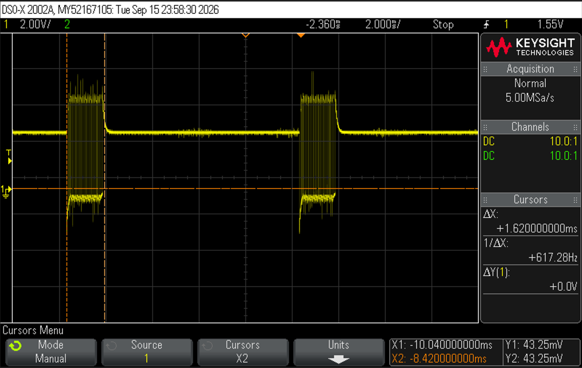

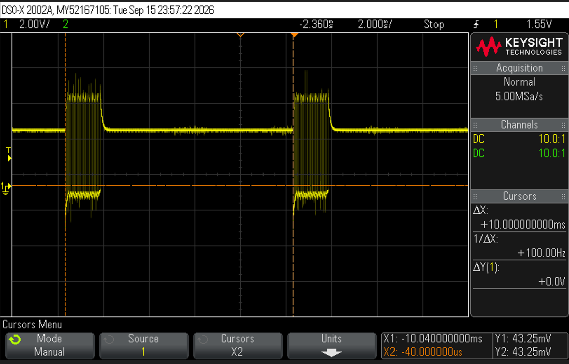

Maybe my sampling issue is related to your timing.
I'm testing at 100 Hz, which means every 10 milliseconds.
Scope1 But I take many samples and calculate the average. 1.6mSec long
Scope2
