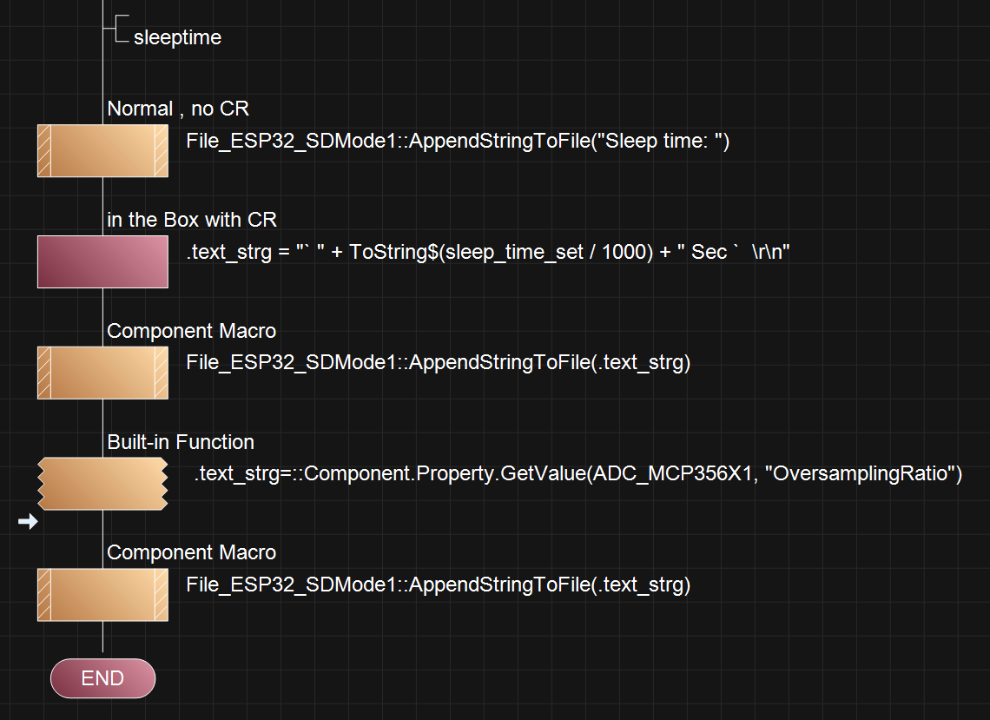

Variables and strings are easy to save,

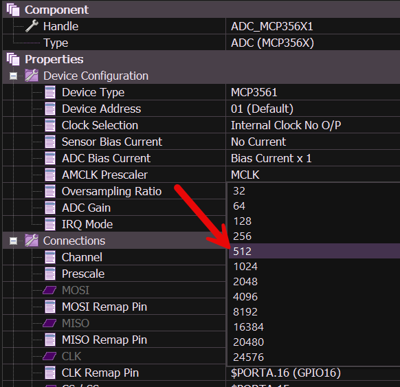

but the properties—for example, those of the AD converter don't work.
It does not change the string variable
How exactly do you do this using the built-in functions?
Or is there some way to do that easier?

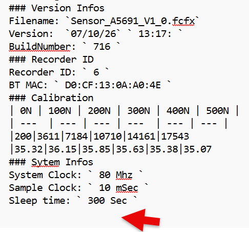

Write command:

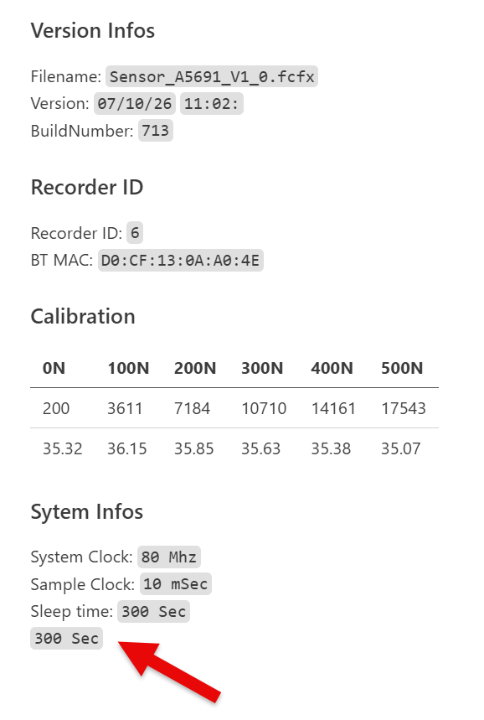

As Demo Result open with a MD viewer:
Write MD Files to Sd-Card Embedded

Property.GetValue should return the current property value as a string. Is that not happening correctly for you?

Hi Steve
In the simulation Property.GetValue the value it shows is 004
I think that's correct.
But in the compiled version running in the ESP32 the string it's empty.

Almost all Inbuilt Function calls in Flowcode are essentially simulation-only. This includes the Property.SetValue function.
If you want to query and store the values in the embedded app itself, then you will need to use other techniques. For example, there is the "AddVar" event which is called for each global variable and constant and allows these to be changed at compile-time to reference property values.
You can find a bit more info about this in the wiki (e.g. here). And there are some examples in the components. For example, the source for the RGB_LED_WS2801 component shows the "RBG" array definition being modified to take into account the number of LEDs.
I rarely use this feature, so Ben might have other suggestions.
