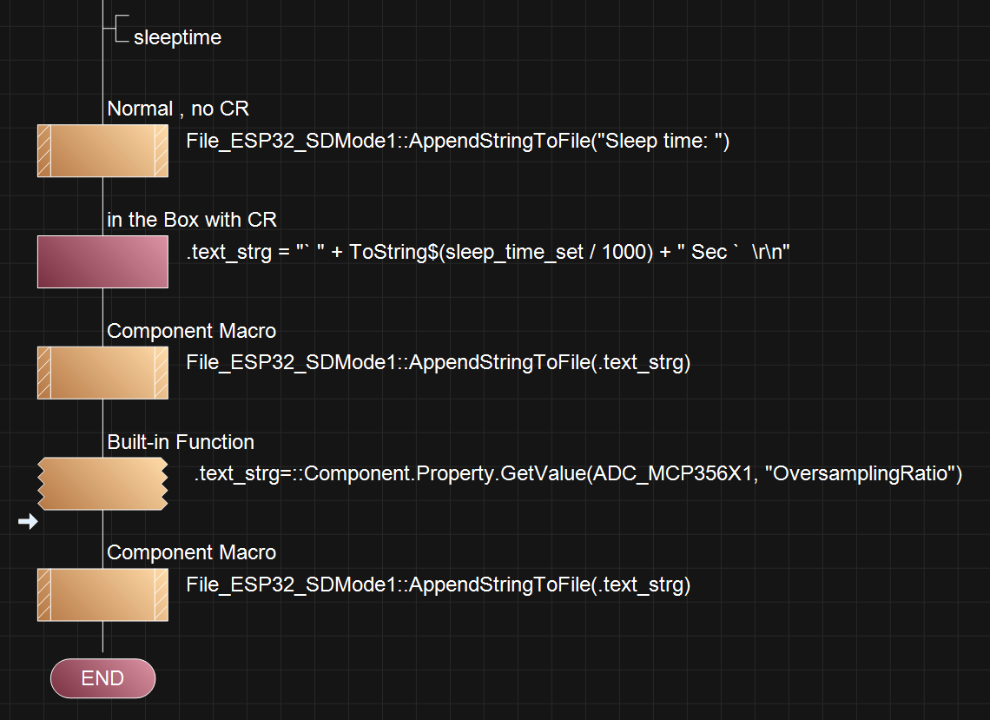

Variables and strings are easy to save,
but the properties—for example, those of the AD converter don't work.
It does not change the string variable
How exactly do you do this using the built-in functions?
Or is there some way to do that easier?

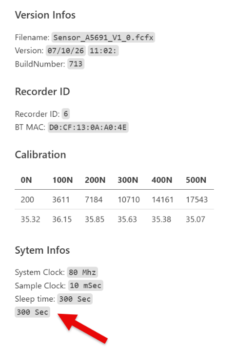

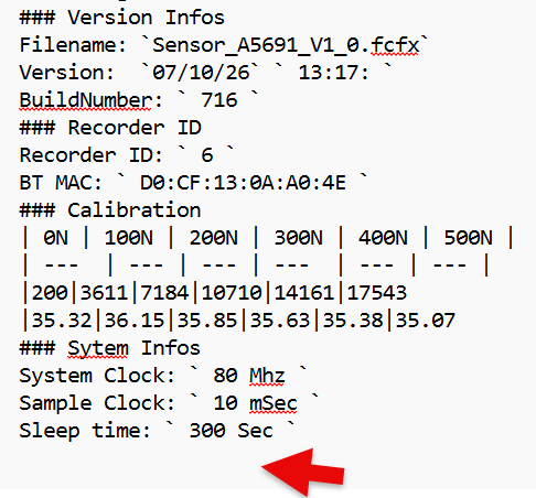

Write command:
As Demo Result open with a MD viewer:

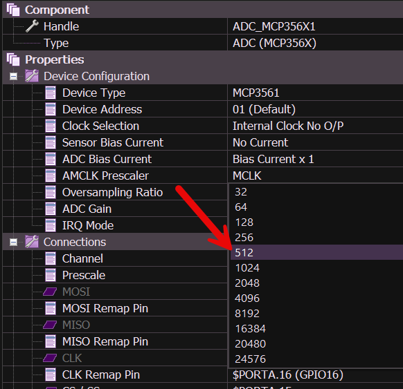

Hi Steve
In the simulation Property.GetValue the value it shows is 004
I think that's correct.
But in the compiled version running in the ESP32 the string it's empty.
