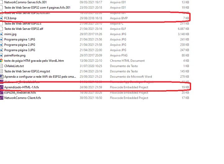

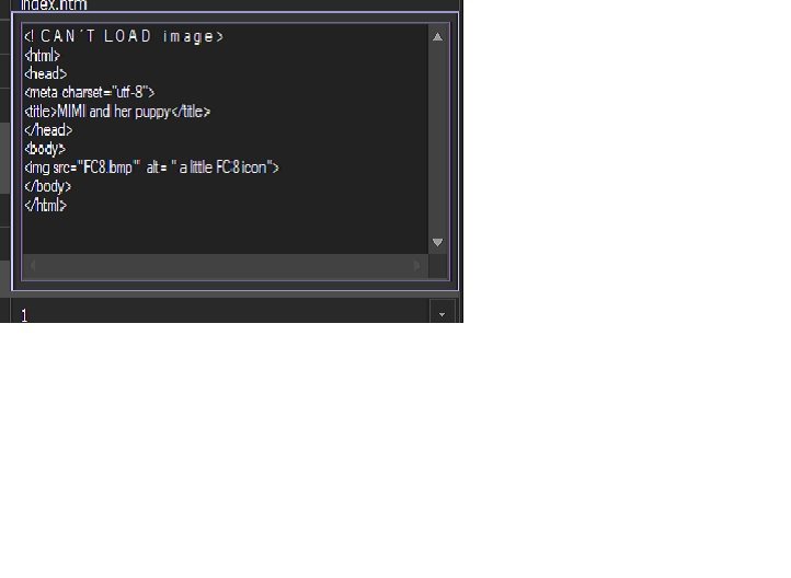

Specifically, I´m trying to load a simple icon "FC8.bmp" image in the "index.htm", as part of an ESP32 WebServer page.
I´ve understood that the "images" and the "fcfx" files must be in the same directory. Is this correct ?
But it seems that didn´t work in this case - the image does not load after the simulation starts and the page loads.
Could someone give some clue to overcome this fact ?

The embedded html source type cannot display external inage resources. You can only use images with the dynamic file type webserver setting. The example in the wiki I linked to should show you how it works.
Let us know how your getting on.
