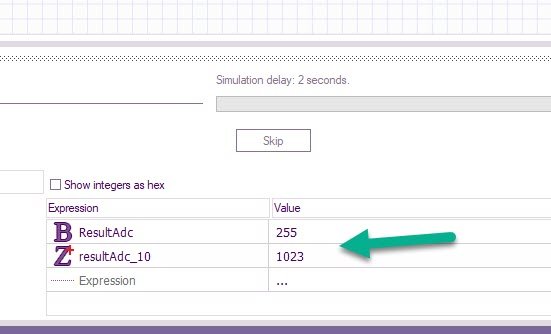

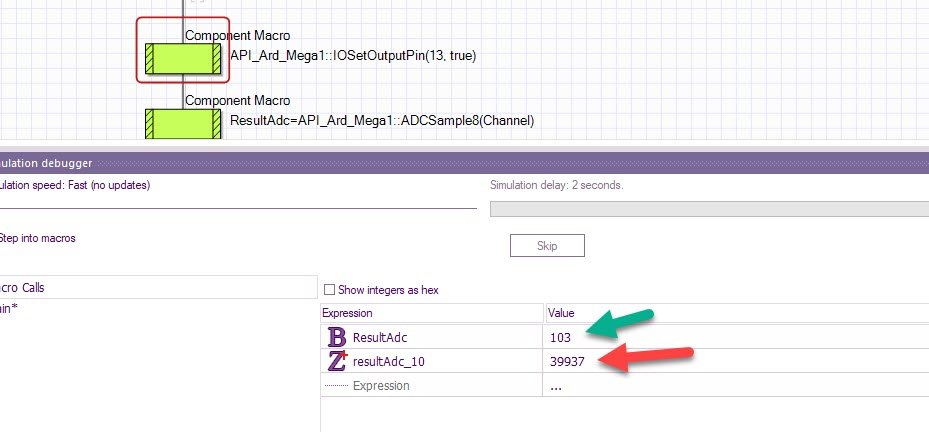

I am not sure what I am doing wrong however using the ARduino mega2560 API-Scada the ADC Sample8 is working fine but the Sample10 is give absolute wrong and impossible values.Samples taking on the same channel(A0) one is correct and the other is not any help appreciated :D

Can you try with the attached component, please?
Hopefully, after adding component, then reloading App Dev it will work as intended?

Hi Martin,
Thanks that is working perfectly now :D
