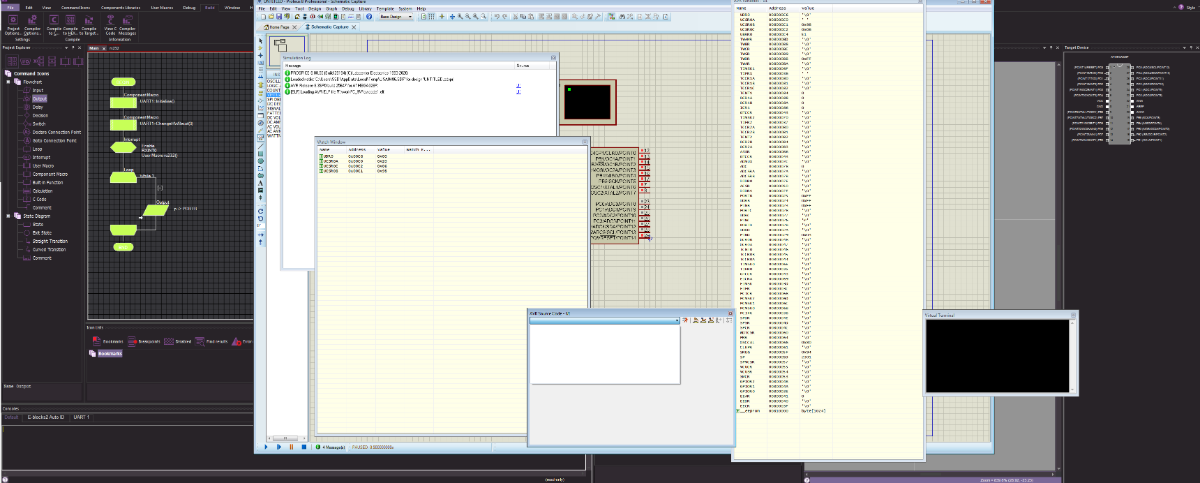

Why can't the flowcode 9 variables be visible in the proteus ???

To see the variables in proteus * .elf file you need in the file avra.bat instead of the key "-Os", register the key "-g". It should turn out like this:
"%~dp0..\bin\avr-gcc.exe" -mmcu=%1 -g -ffunction-sections -fdata-sections -funsigned-char -o %2 %3 -lm -Wl,-gc-sections.
In this case , the compiler will create a file .elf without optimization and proteus will be able to see the variables.
File avra.bat is located in the folder: "C:\Program Files (x86)\Flowcode\Common\Compilers\avrv5\batchfiles".

thanks, it worked
