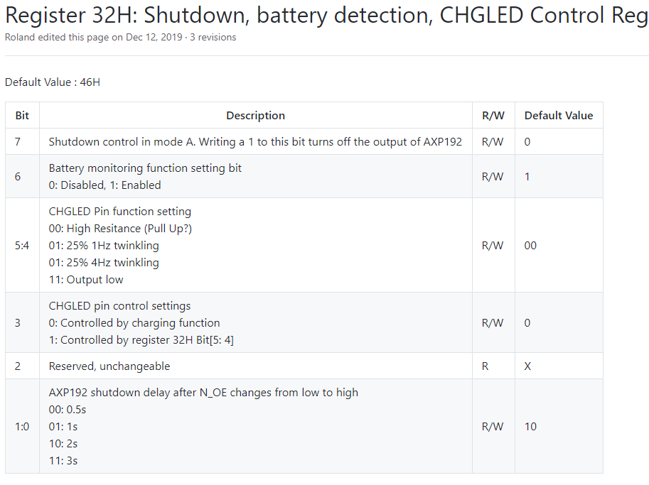

I tried both versions but I always get 0. With the oscilloscope I have clock and data on the correct pin.
Posts: 1277
Has thanked: 245 times
Been thanked: 256 times
Re: ESP32 Board with AXP192 Power management
I think the register 32h is 0.
I tried some another register with your first code and there I get the correct value.
Posts: 2274
Has thanked: 633 times
Been thanked: 837 times
Hi Stefan
In the example code there is a far bit in the initialise function code. It might be it needs setting up to work as expected?
