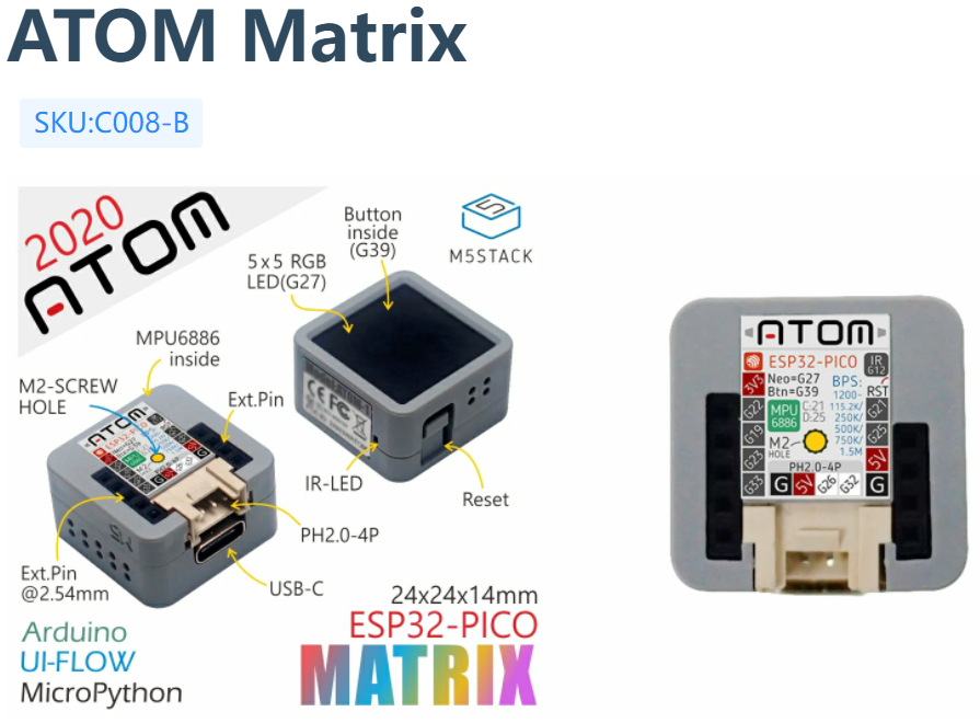

The button is the only problem.
When you press on the LED display, a button closes. This is on port G39.
However, this port G39 does not work with FC9 as an input.
I tested all external ports from this board:
The following ports work as an input
G21,G23
The following ports do not work as an input
G39,G33,G19,G22,G25
Is there a possibility that these ports work?
