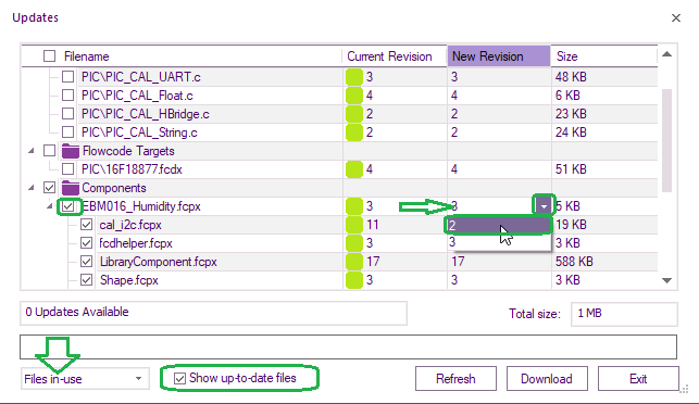

Re: EBM016 Humidity Sensor - no longer works after latest update on Flowcode V9
Thank you for the spot and sorry for any issues the update has caused.
Yes, you can rollback.
If you Select Help, Library Updates
Click on Show up-to-date files.
Make sure Files in-use is selected.
Scroll down to components and click on EBM016_Humidity.fcpx
In the New Revision section select the dropbox and change to a previous version.
In your case, it will be 2.
When the change has been completed, you will need to reload your flowchart for the change to take effect.
Post by SuffolkOne »
Thank you, the rollback worked.
