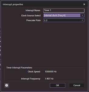

I was thinking about marking this topic as Solved but, at the very last moment before I did it, another related problem arose:
I found result frequency doesn't change with different options from Clock Source Select ,
at least for any PIC16LF18446 timer interrupt properties where this drop down exists: TMR0, 1,3 and 5 .
Some examples ...
Some examples ...

Re: PIC16(L)F18466.fcdx with wrong definitions (continuation)
We are aware of this issue. Please see here:
viewtopic.php?f=5&t=1231&p=6844#p6844
