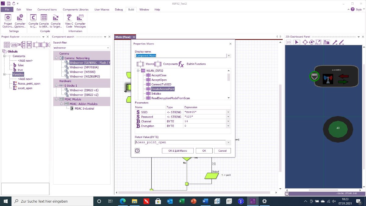

can anyone help me to create an Access point with an Esp 32. i tried something but i can't get it done. does anyone have an example?
Berend
test32.fcfx
(9.89 KiB) Downloaded 815 times

I tried to open a acess point too
If I set the Encryption to ZERO the acces point will be opened at the ESP32.
Ican sent a pint to the ESP32 too.
Is there maybe a tutorial to learn mor about setting up the WLAN correctly and installing/creating a web page inside the ESP32??
