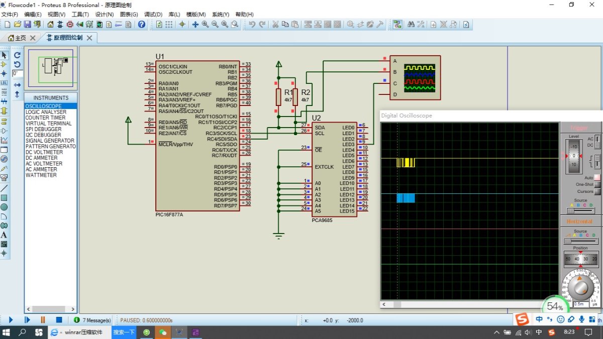

I do not use Proteus so cannot help with your simulation.
However the code I provided in your original post (v8 forum) has been verified to work in hardware.
