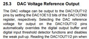

Most PIC micros have 1 DAC which has an output on pin A2 which is what the flowcode component is setup for.
the dac output can also be set to output on B7 instead of A2. see attached text from datasheet
is it possible to change the internal dac component to allow selection of A2 or B7 as I use port A as inputs

What device are you using and I'll investigate for you.

Typically PIC16F1789 OR PIC16F18877

also pic16F1786, generally it appears to be RB7 as alternate pin

I've now added the alt DAC pins on the devices you mentioned. Updates should now be available via the library update system.
Please let me know how you get on and if you spot any further devices that need this mod.

could you add ALT DAC pin RB7 TO DEVICE PIC16F1717 please

That's been done for you now, thanks for letting us know.
