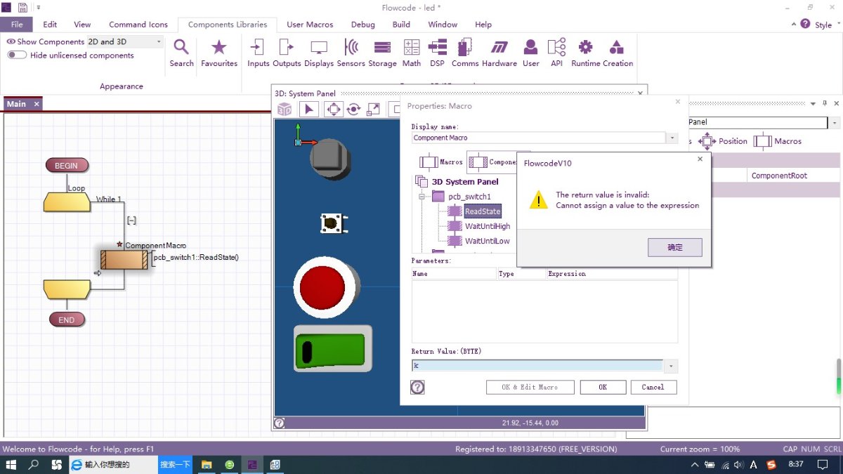

Flowcode v10 All Switchs not work
Post by niedian »

ALL Switchs not work.The return value cannot be set.

All switches do nothing
Post by niedian »
All switches do nothing.

Re: All switches do nothing
Thanks for letting us know.
I'm investigating the problem for you now, it seems to be something specific with the 3D panel.
For now while we solve the problem you could instead use the 2D components on one of the 2D panels.
We've investigated this issue and found the problem.
The problem occurs because target device you are using does not have a valid PORTA.0 pin and v10 now includes additional checks to ensure port and pins in calculations actually exist. Your project should work if you change the target to one with A0.
Unfortunately it seems the fix requires a new version of Flowcode and we can't simply issue a component fix via the library updates. This will take a little longer to do, but I hope we can have a fix within the next week or so.
