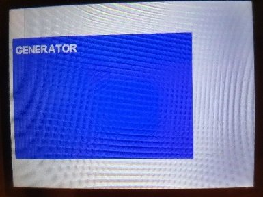

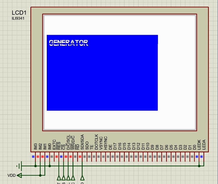

I have a problem with the text output on the display IlI9341

Hello Osta,
Have you tried on the hardware to see if it does the same thing there?
Any you using the latest component updates using Help -> Check for updates menu?
I have a display here I can try if you're still getting the problem.

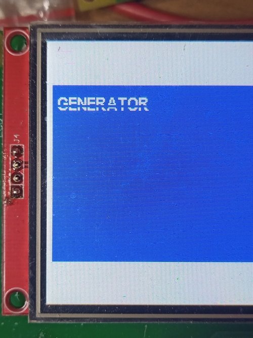

Yes, I always debug in the proteus and then in the gland.
Updated all libraries the result is the same
iron

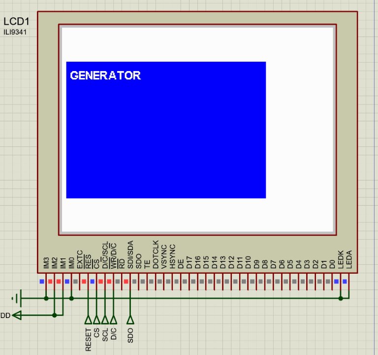

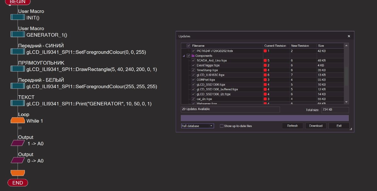

Took me a while but testing here and it's all working correctly. Have you used the Help -> Check for updates to ensure you are using the latest version of the component?

Re: display IlI9341
Post by Osta »
Yes updated!
Everything became normal !!!
Thanks!!!
