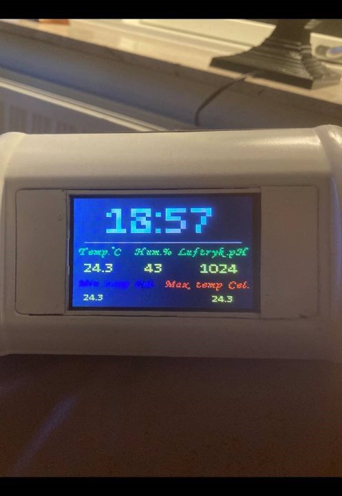

Thank you Martin. :D I will make a test. As you see I have made a project using the circle.
Just perform a test on a Ili9341 Only the C is on the screen?
I will not hijack the tread ;)

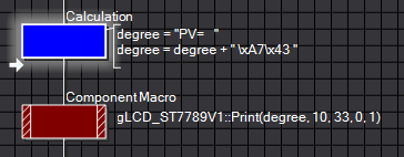

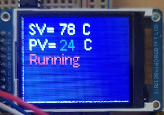

Hi guys
I have tried this but no luck have dun full update and everything not sure what I,m doing wrong
Degree symbole.PNG (12.45 KiB) Viewed 10131 times
Posts: 2454
Has thanked: 792 times
Been thanked: 851 times
Re: ST7789 display
Hi Brian.
Have you tried with the default or system font?
They are the only fonts that currently have the degrees symbol.
