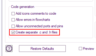

Another difference between my Flowcode output and yours is I am using separate .c and .h files. You could try this setting (in Global Options) and see if this works for you.

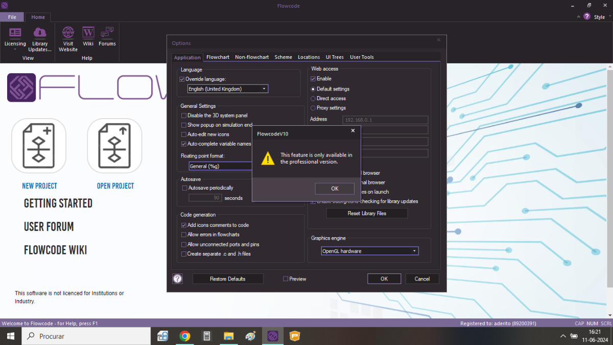

aderito
Posts: 37
Joined: Sun Jan 29, 2023 12:49 pm
Location: portugal
Has thanked: 19 times
Been thanked: 2 times
Re: error when compiling with fc 10
Post by aderito »
Unfortunately it looks like I won't be able to do that..... :|
opcoes globais.png (319.45 KiB) Viewed 7952 times
Posts: 1971
Has thanked: 294 times
Been thanked: 458 times
Ok, no problem. I don't think that would solve it anyway.

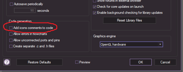

Following your instructions, I unchecked the "add icons comments to code" box and to my surprise it is already compiling..... :P :P
I hope there are no more surprises in the future and I thank you in advance for all the effort you made. :D :D
Perhaps it will also serve as an example for other people with a similar problem. :idea: :idea:
