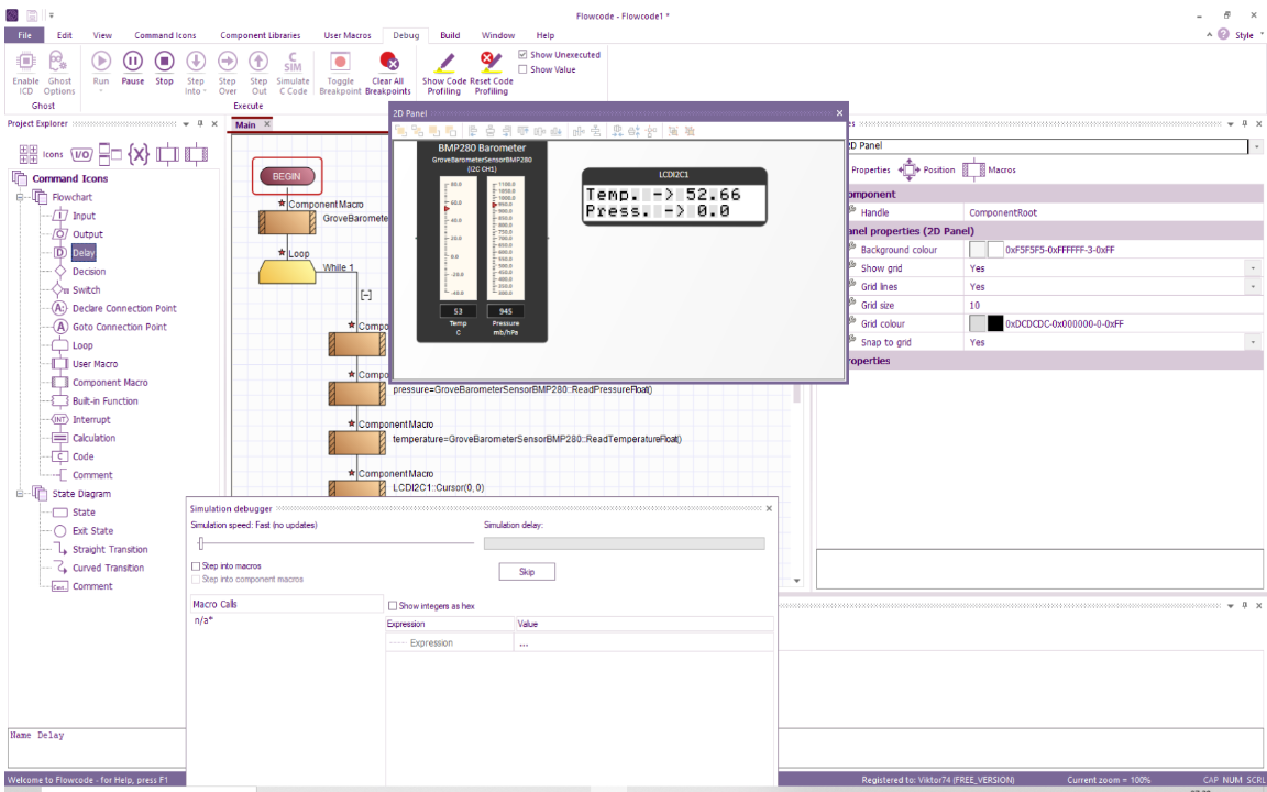

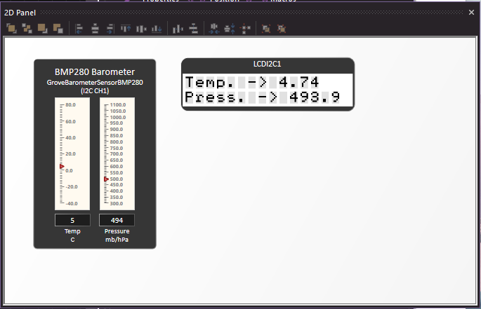

HI. Cannot read BMP280 pressure, what is the problem?

Simulation of your project is working for me.
BMP280 Pressure sim.png (38.69 KiB) Viewed 6529 times
I would recommend doing a full component update
Help > Library Updates...
Change Files in-use to Full database.
Then reload your project and try again.

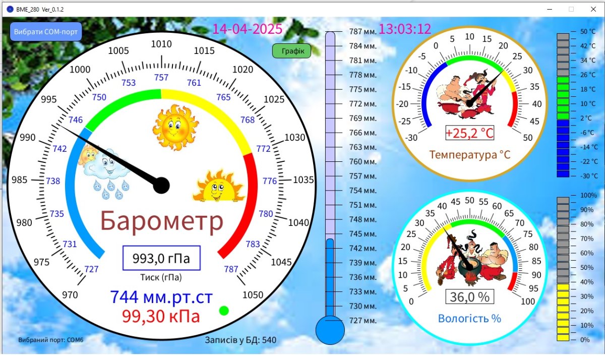

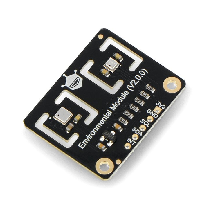

Hi Martin. A little off topic but I thought I'd ask, I have a BME280 sensor on the same board with an ENS160 air quality sensor. The BME280 works fine and reproduces all the parameters, but the ENS160 is not connected. Could you help me in any way? Or maybe you already have such a macro for ENS160? I want to use the entire module of 2 sensors. I have written a small program (but only in Ukrainian) that works with BME280, but it lacks ENS160. Thank you very much for your understanding!

Hi Victor,
The image you have shared that shows the BME280 looks amazing!

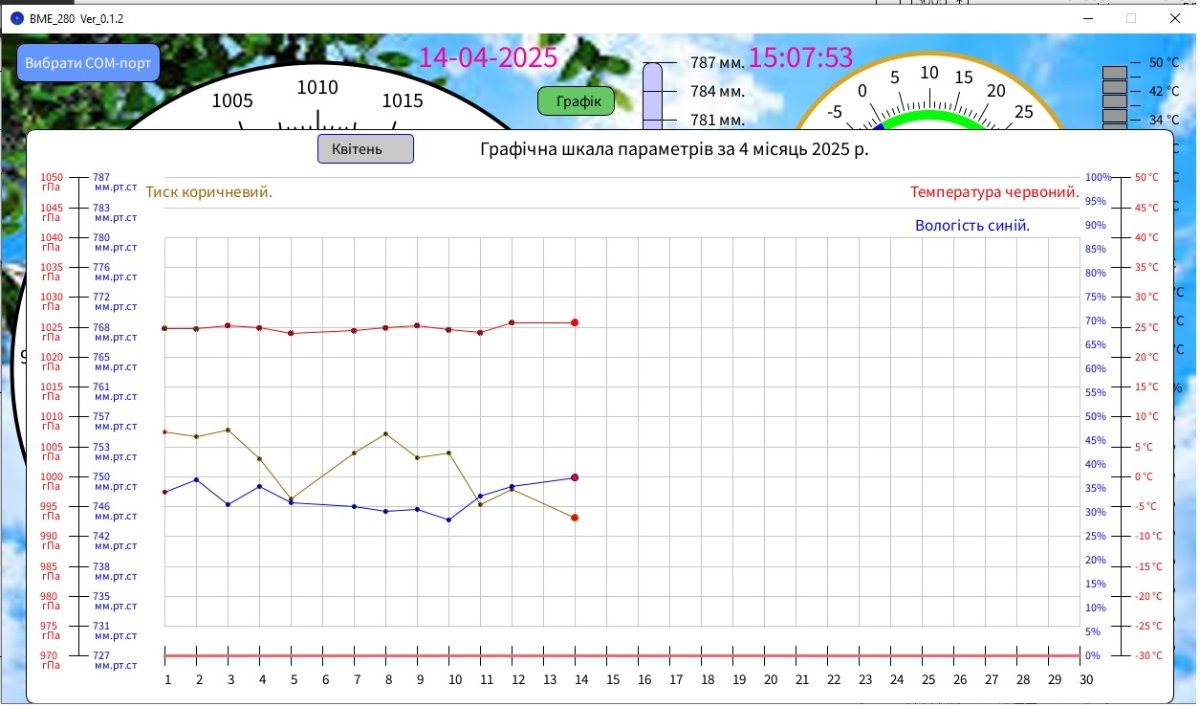

Martin such a register is also written to the database and draws a graph. I tried to find information about the macro for the ENS160 on the forum, but it was not successful, unfortunately, it was all to no avail. Maybe I'm doing something wrong in the forum search.
