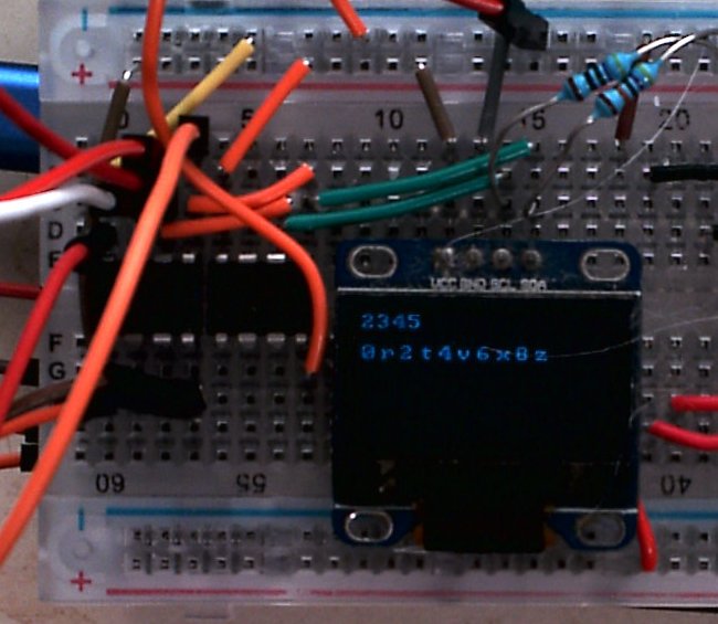

I set up a PIC16LF15313 with a SSD1306 i2c (128 * 64) display. This PIC only has 256 bytes RAM - so I used my minimal ssd1306 component (see viewtopic.php?t=2742&hilit=ssd1306&start=40 ) otherwise no chance....
I also attached a logic analyser - and with i2c set to hardware mode - nothing on SDA and SCL. Changing to software mode and there is life.
Oddly for writing 0 .. 9 I got on the display 0 r 2 t 4 v 6 x 8 z (and I used .x = Read(.i) Print(.x + '0', .i * 10, 2) So- not sure quite what is happening on the odd numbers. I couldn't use PrintNumber - insufficient RAM!
So - try software mode on the i2c. It might just do the trick?
Rather a rats nest - with PICKit and logic analyser attached. The oscilloscope is 'underneath' the breadboard - and there are some bits from my dfplayer tester to the right. Display is also not very bright (it's rather old) - I print some text ("2345") to prove it can display odd numbers - next line is the first 10 bytes read from EEPROM. The PIC is at the left - eeprom in the middle, with the i2c daisy-chained from a1 and a2 (the display and EEPROM have different addresses, so this is okay).
I modified slightly - and printed the address in row 2 and data in row 4 - and row 2 is correct (0 1 2 3...) but the data still has the odd characters (though there is a pattern - they are not random)

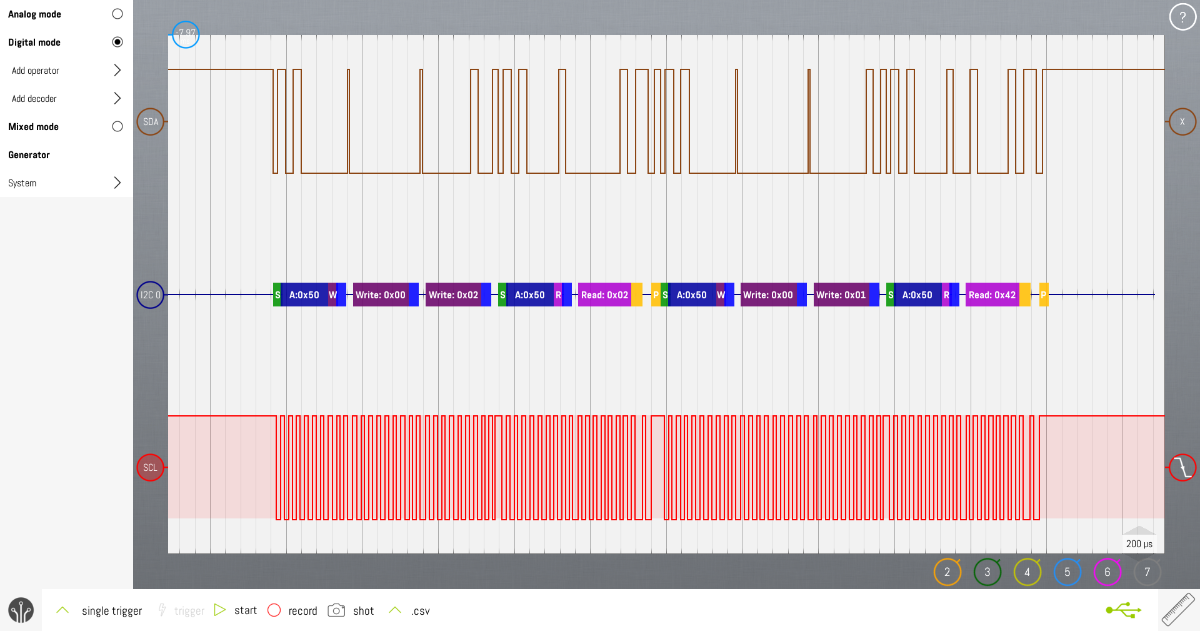

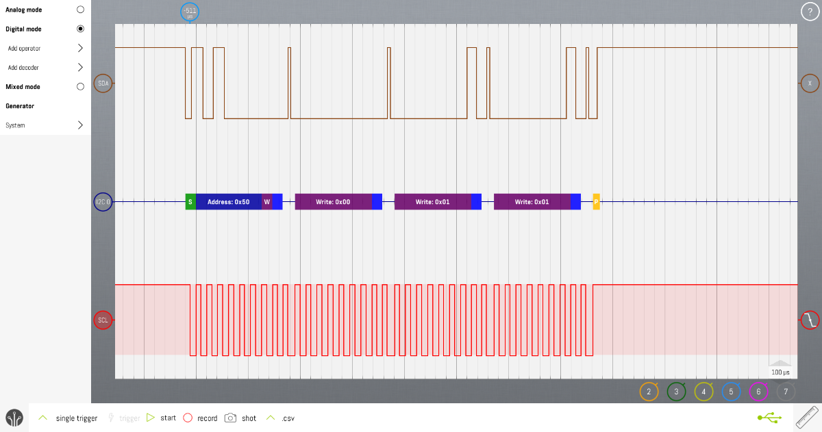

It's very odd - looking with the oscilloscope - the write looks correct, as does the read. However whereas for the even addresses it returns the correct data, for the odd addresses it doesn't (for example address 1 returns 0x42)
Very strange. Here is the trace showing the write to address 1, followed by the trace showing read of address 2 then address 1
Anyone any idea what's going on?

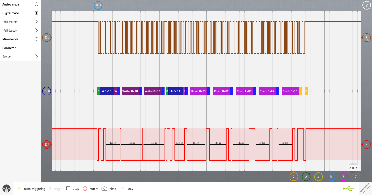

So after a bit of fiddling - I went back to an old version of the 24LC256 component I did a while ago.
Now up and running smoothly in software mode (hardware mode doesn't seem to be supported?)
In a simple demo - it writes 10 bytes (1,2,3 .. 0) to the eeprom then repeatedly reads back the first 5 bytes - shown here on the scope trace. Note that the component works slightly differently to the FC one - the user sets a read and/or write address using StartRead and StartWrite - then they can read or write single or multiple bytes using ReadData and WriteData - and these automatically increment the address to use.
