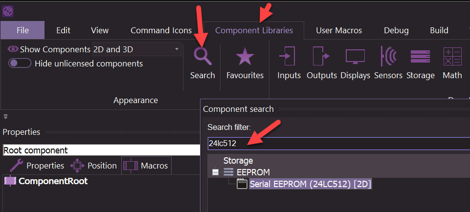

You can test with the component from Flowcode
search for "24LC512" and drag and trop it.
This is comfortable to use.

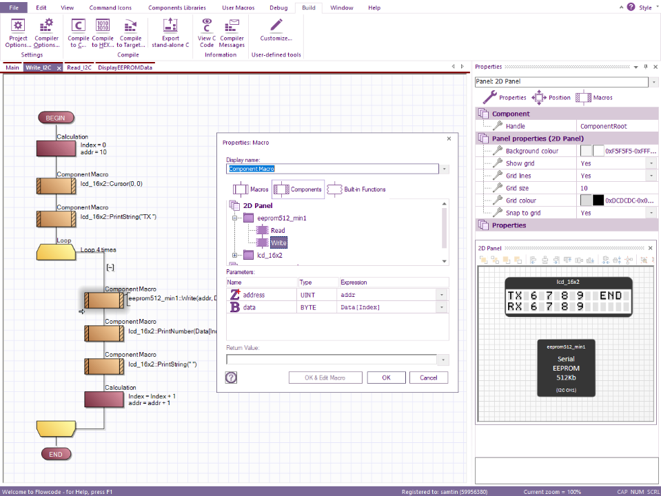

Cut the component down to it's bare minimum. Read and Write. It should compile - and I've tested on an Arduino and it works there...
To install:
1) Save the .fcpx file to a directory - point FC at this in Build->Customise->Locations->Search for components in. Close and re-open FC.
2) Search for the component (it's called EEPROM (24LC5212) Minimal)
3) Use Read and Write. Note that i2c requires pull-up resistors on SDA and SCL
You'll need to add some code to display the values. Let us know how it goes :-)

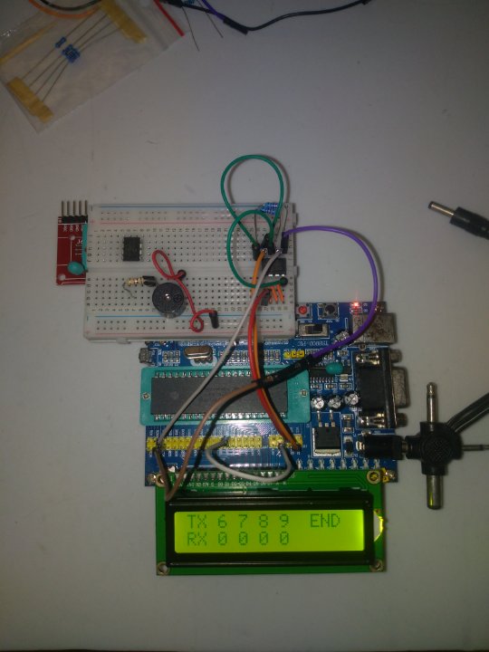

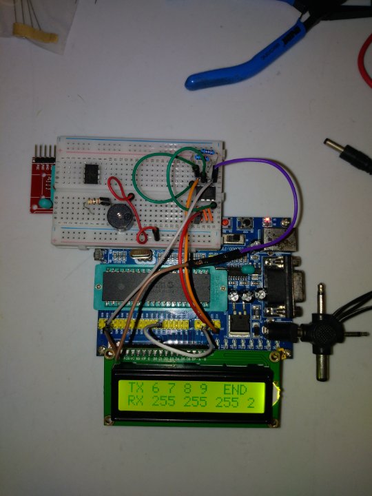

Hi Martin,
First of all, I have to thank you for your help. This time it compiled, but it doesn't store, it seems, because it displays 255. In Flowcode it simulates correctly, but it also simulates correctly with the Flowcode component unmodified, only it doesn't compile. Always the pull-up resistors are connected, I also pay great attention to the connections between the microcontroller and other components such as this eeprom.

Odd, it is just the component - I've not modified it, just deleted the page functions...
Do you have a logic analyser - take a look at what is on the i2c.
You don't have the 'protect' pin pulled high by mistake?
