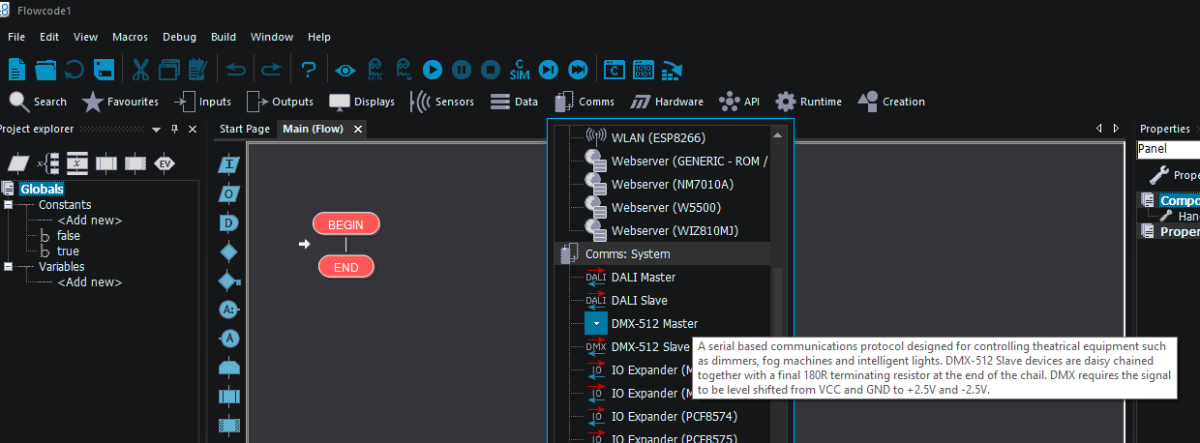

As I understood you have a project in FC8 to build a DMX controller.
I checked the FC8 comm components. Dmx library is for slave only(?).
Hi Viktor,
Thanks for the Info but I can assure you that both the DMX 512 Master and Slave are in fc8, unless of course the master has been removed as there is an issue with it since I downloaded the program - unsure how to check that.

I have both Master and Slave on my v8 however (and this is just a guess) up untl v10 you had to buy component packs and you had CommsA / CommsB / CommsC so perhaps Slave and Master are in different packs?
Pretty much irrelevant now as ALL are free to use in v10.

I think this is the case.
I have only slave.
