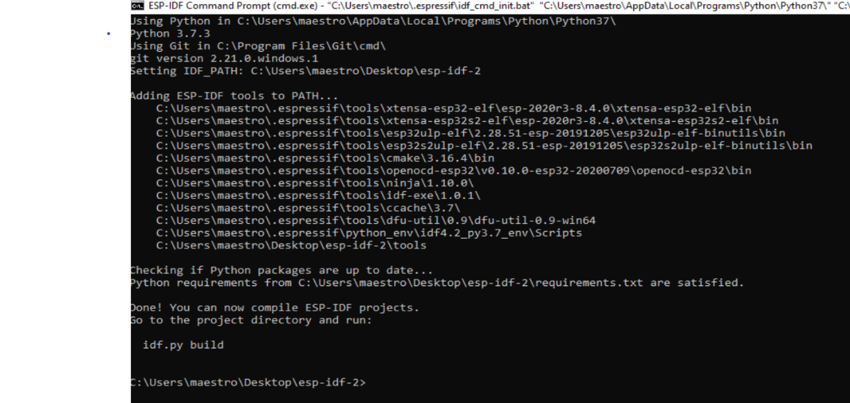

my new Command Prompt
- K.png (377.68 KiB) Viewed 13473 times

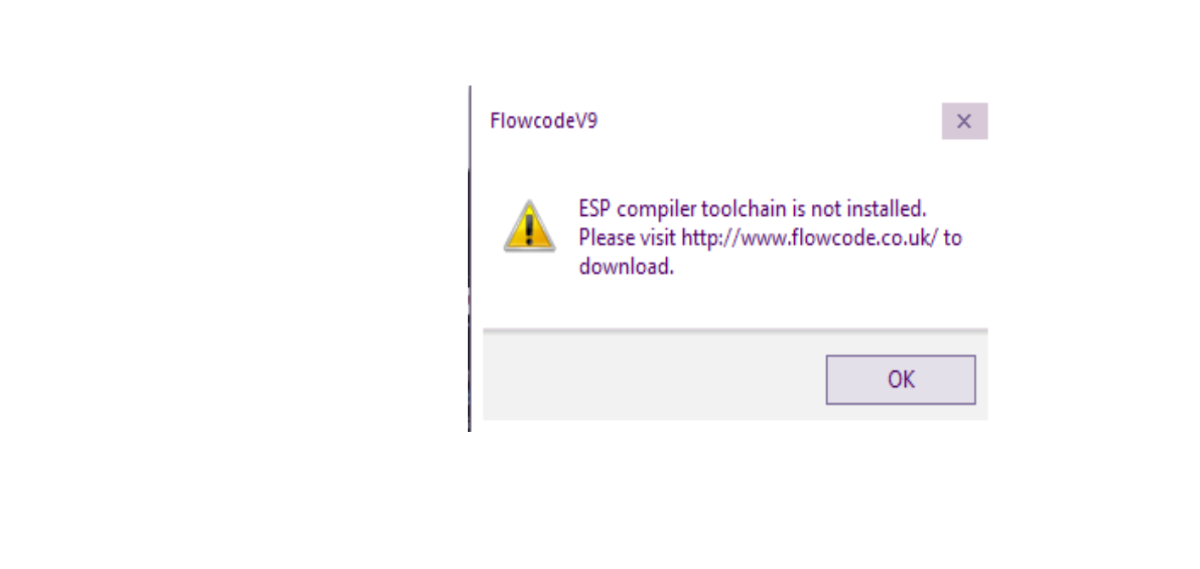

Unfortunately still this message appears:
I will also study these new messages which came in between
- L.png (67.97 KiB) Viewed 13471 times

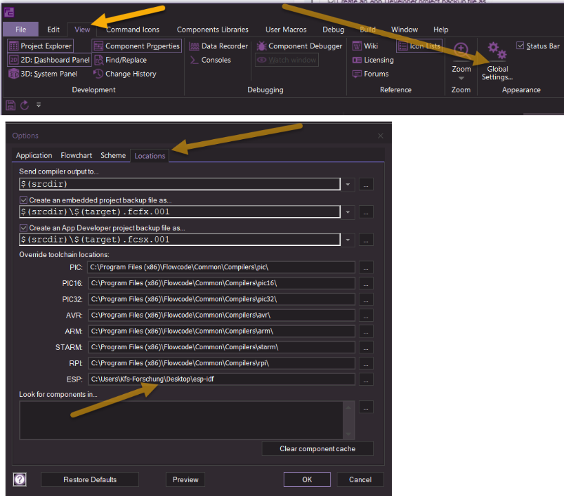

Re: ESP 32 Toolchain problem
You need to 'point' Flowcode at the ESP toolchain location. Open Flowcode and set it in the "Locations" tab of "Global Properties".

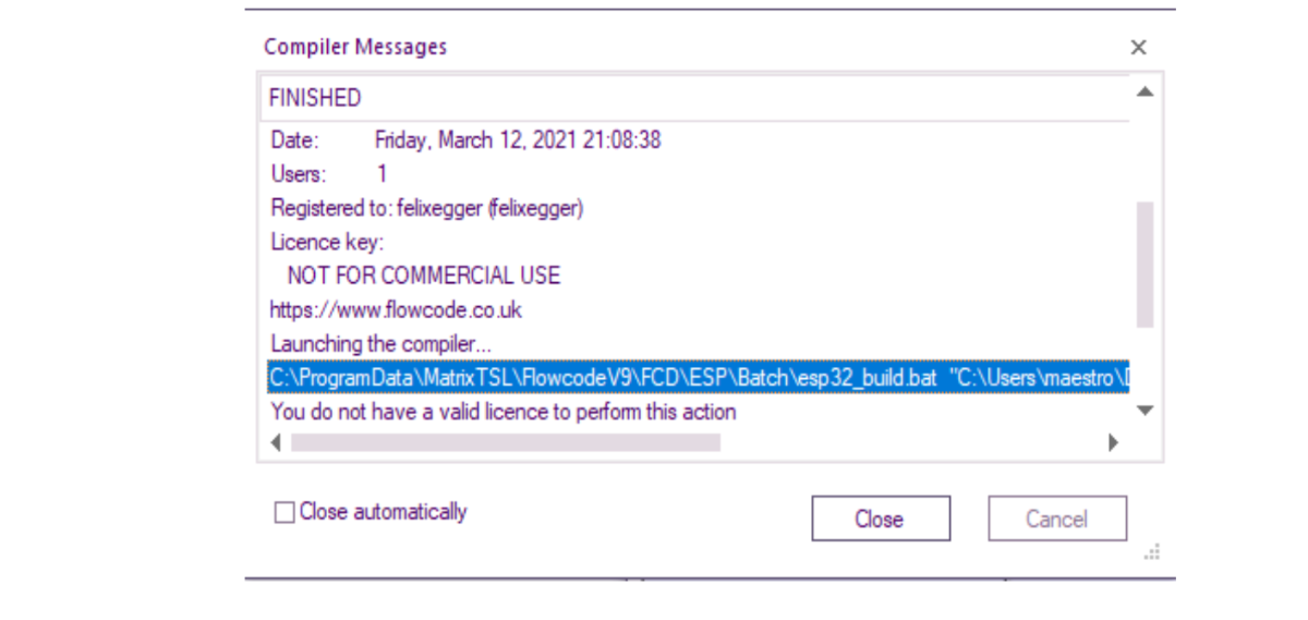

Is that correct, that I can't send my program to my ESP 32 for licences reasons as the following message shows ?
Felix
Now I'm one step further. The Toolchain was installed now.
Felix
- T1.png (171.68 KiB) Viewed 13464 times

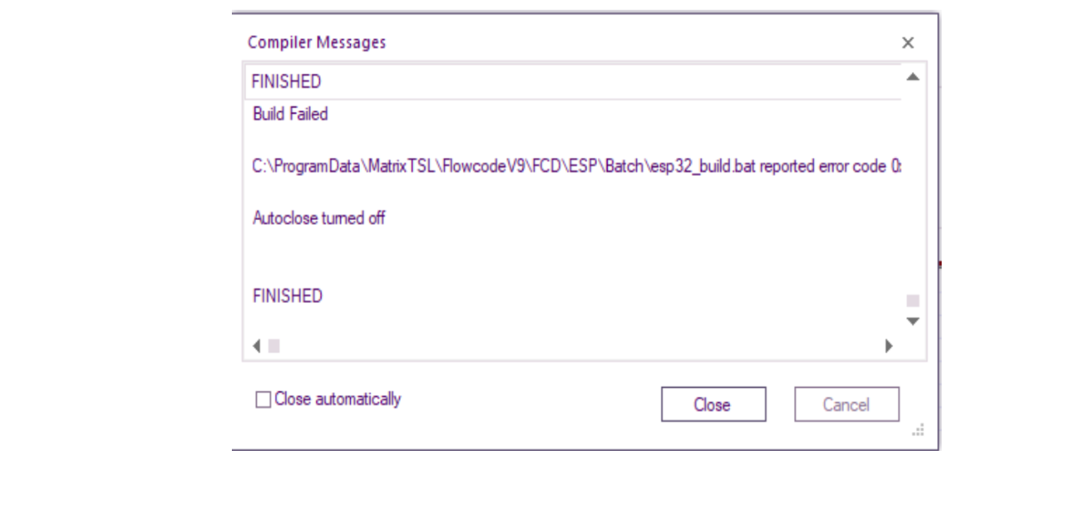

After several trials I'm getting now the following message, although my ESP 32 was connected properly :
- U.png (88.88 KiB) Viewed 13464 times

Ok it sounds like the toolchain is now setup correctly and Flowcode is pointed at it correctly but your program is generating an error.
Please can you attach your .fcfx program file and we will have a look at what is causing the compilation error for you.

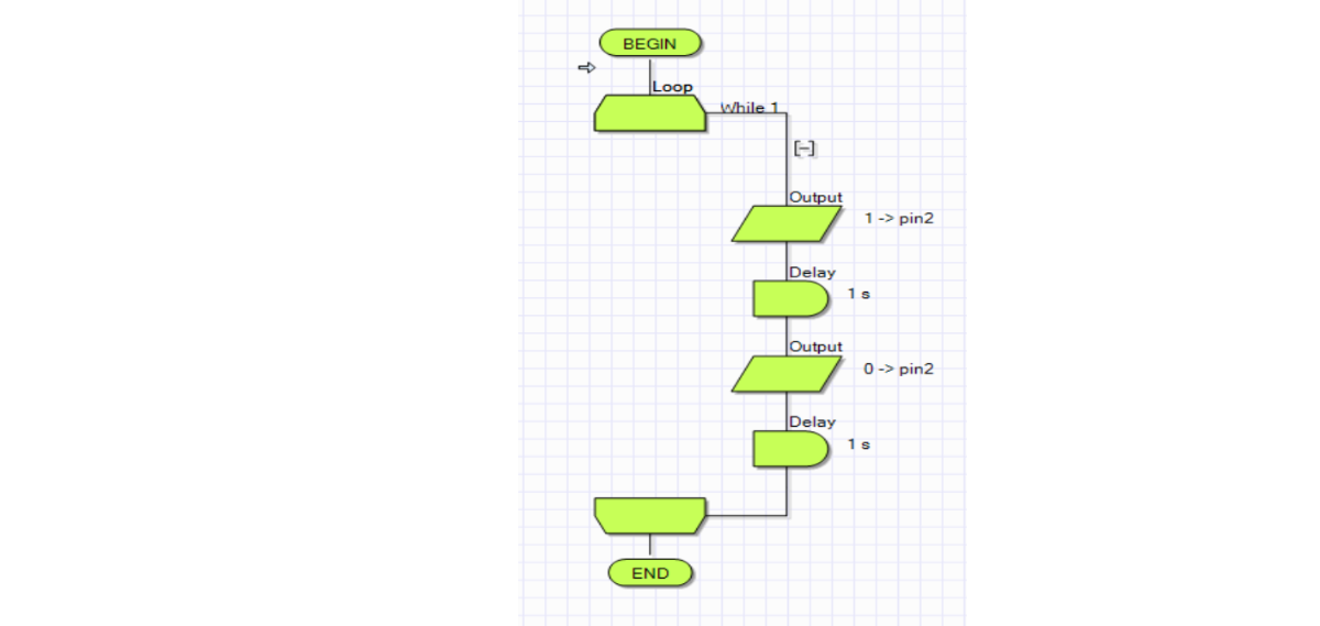

My file is very simple and it looks like this.
Otherwise I don't know how to upload my fcfx program to you.
I'm using a ESP32 WROOM 32
- pcode.png (80.97 KiB) Viewed 13445 times
