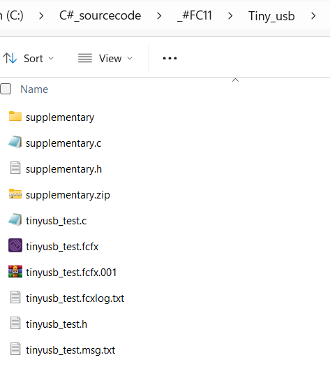

I made a copy of supplementary.c supplementary.h from the supplementary folder to Tiny_usb
I did not help...

May also need "main"?

Yes - supplementary.h & .c need to go into tiny_usb (project directory) /main/includes - and add includes to CMakeLists.txt as above.

ok I create main and all...
In file included from C:/Users/Kfs-Forschung/Desktop/esp-idf-2/mtxesp32_s3_sdkconfig/main/esp-project.c:20:
C:\C#_sourcecode\_#FC11\Tiny_usb\tinyusb_test.h:64:10: fatal error: supplementary.h: No such file or directory

Odd - the main directory should be created with the project - you could try either pasting the .h and .c files into the supplementary code (instead of the #includes) or give them a fixed address (#include "c:/test/file.h")

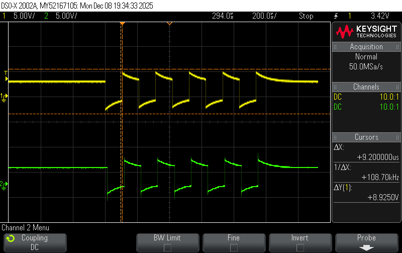

The image shows how UART0 and UART1 work and, incidentally, how UART1 is only slightly delayed and not, as assumed, only when uart0 is finished.
