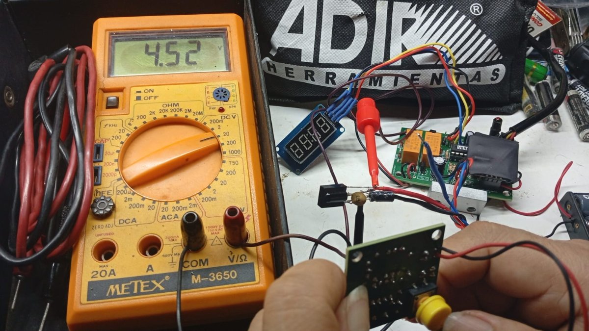

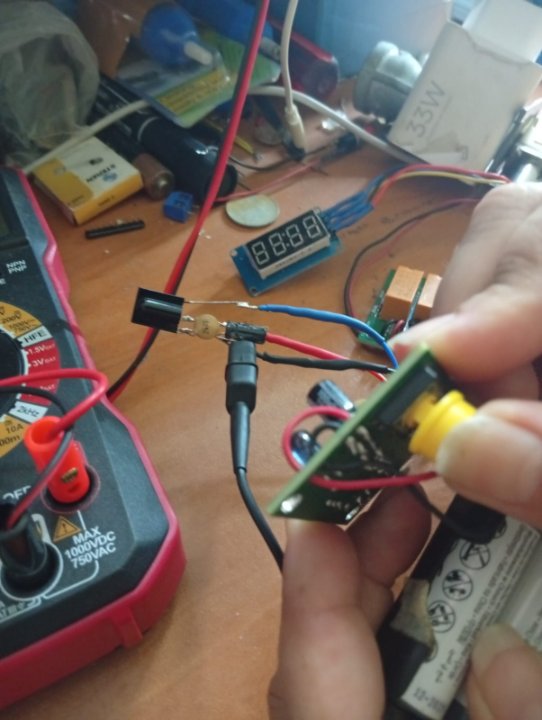

Hi Martin,
When checking with a multimeter, there is no change upon applying the signal; in tests I have conducted, when a 36 kHz signal is applied to the carrier or base of the component, the component's voltage drops to zero momentarily and remains steady at approximately 4.5 V.

Just tested RC5 component on Flowcode v11 and working for me.
Can you be 100% sure that the infrared transmitter is sending RC5 pulse train?
Mine is and the LCD on my Eblocks3 is showing what button on the RC5 remote was last pressed.
As you are using a DMM, the voltage will be VDD with no key pressed.
If you press and hold down the volume button for example.
If both transmitter and receiver are compatible, the voltage should drop by at least 1V
If there is an hardware issue the voltage remain steady at VDD.
When you use a scope or logic analyser, of course the voltages will vary from 0 to VDD as they will be a train of pulses.

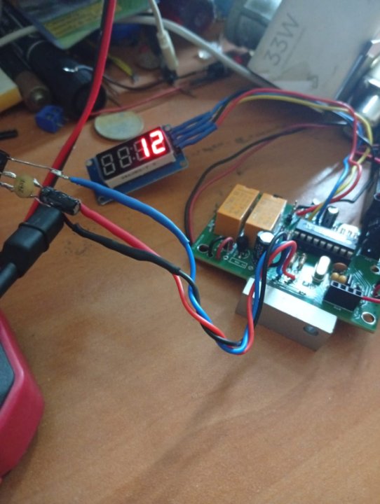

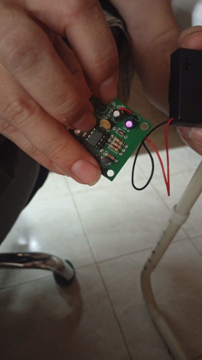

I tested this using Flowcode 11 and connected a display from an earlier version. I am attaching the TX and RX flowcharts. For the RX side, I started by setting the display to show "12," then entered a loop that checks pin RC5 and turns on LED A2 to indicate that the RX check is active; if data is received, it should be shown on the 4-digit TM1637 display. There might be an error in the flowcharts; LED A2 does not light up, and while the display shows "12" at startup, it does not show the received data.
I am also attaching the TX file, which sends the number 55 as data; like the RX side, it might contain a flowchart error. Observing it with a mobile phone camera shows that the IR LED is indeed transmitting a signal.

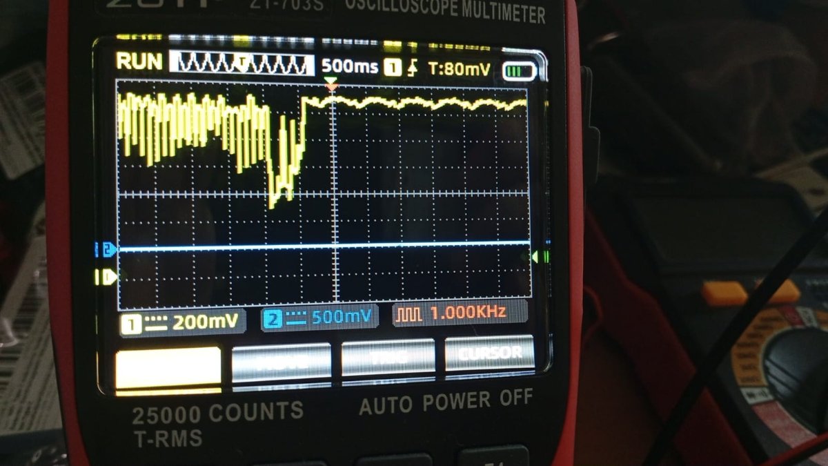

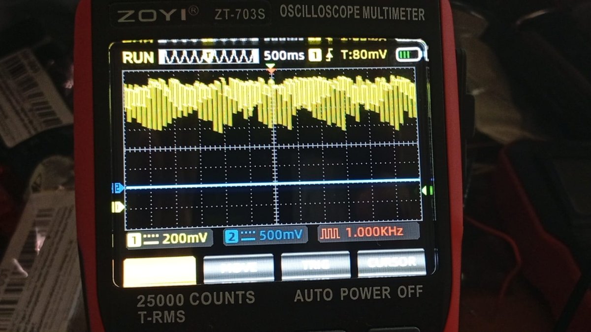

I got a small oscilloscope. The signal stays high when the IR transmitter button is pressed, and the signal varies when the RX receiver is not receiving a signal; however, when it *does* receive a signal, LED A2 does not light up (it fails to detect the RX signal), and the display shows no data.
