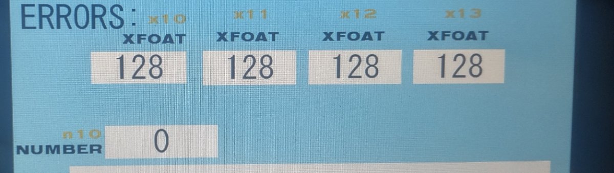

Re: Protocol j1587
Thank you very much "minfisher" for the example, it helped me understand searching for data in the buffer.
Now there is a new problem: the bytes are repeated on the screen, although I display them in turn from "Mid_array[0] to Mid_attay[3]. What could be the problem?
Regards Joni!
Regards Joni!

Re: Protocol j1587
I think the issue is - your code continually searches for 128 - and as soon as it is found - attempts to read 4 bytes from 'after' the 128.
These may not have been received yet...
So - one solution is wait for 128 to be found then wait until caunt_rx >= 4 and then display the values.

Re: Protocol j1587
Hi all!
I tried V1.7 but the repetition is still there, I changed the delay but alas to no avail, everything is perfect in the simulator.
I’ll transfer it to the mega2560 in a minute and try, maybe there’s a problem with the controller.

Re: Protocol j1587
Odd, how about waiting until the value changes from 128 - it sounds as though only the start byte is being received correctly. Can you just display (or send to uart) all the data received?

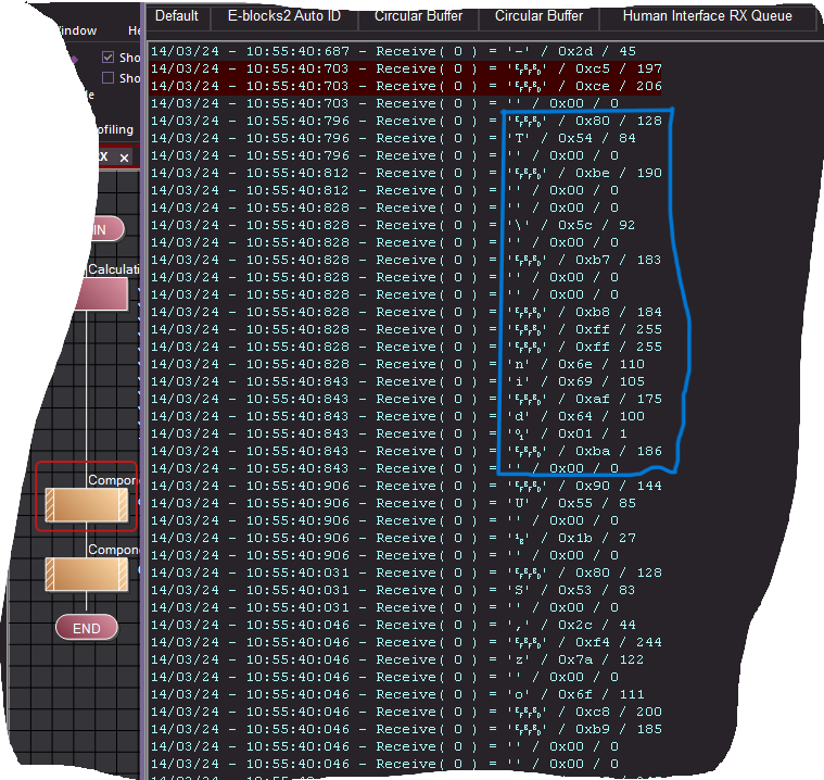

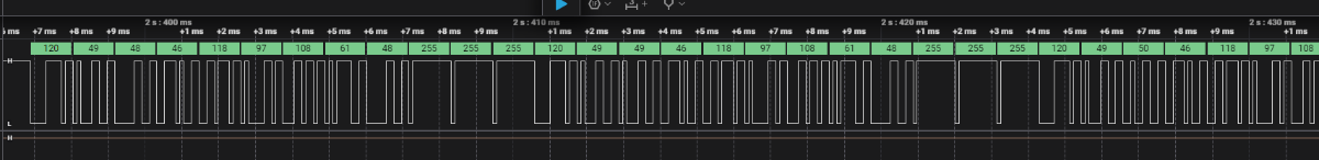

Re: Protocol j1587
Here are the screenshots
The controller receives the same data as the FC
- Out STM to LCD.png (53.07 KiB) Viewed 7464 times
- J1587 in to FC.png (96.52 KiB) Viewed 7464 times
