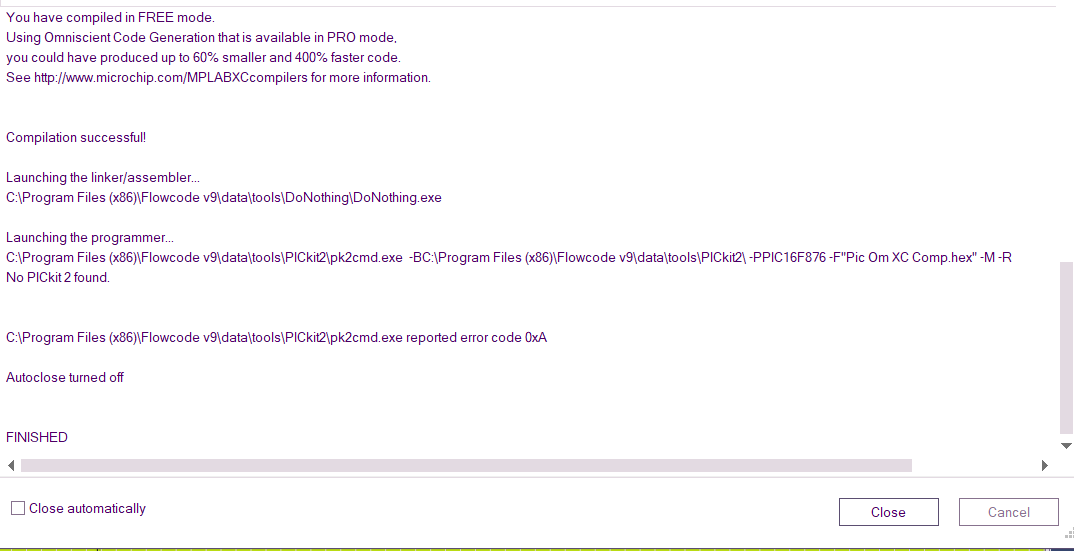

Still not possible to upload to 8bit Pic. No error or warning. Look like there no connection to EB board?
Br jorgen
Br jorgen

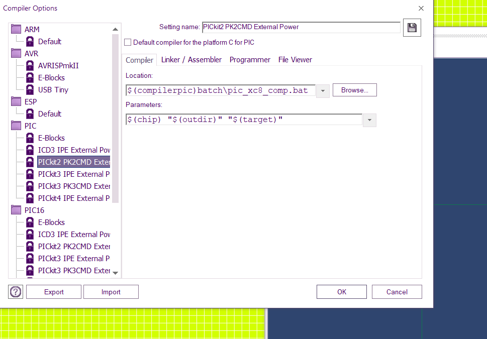

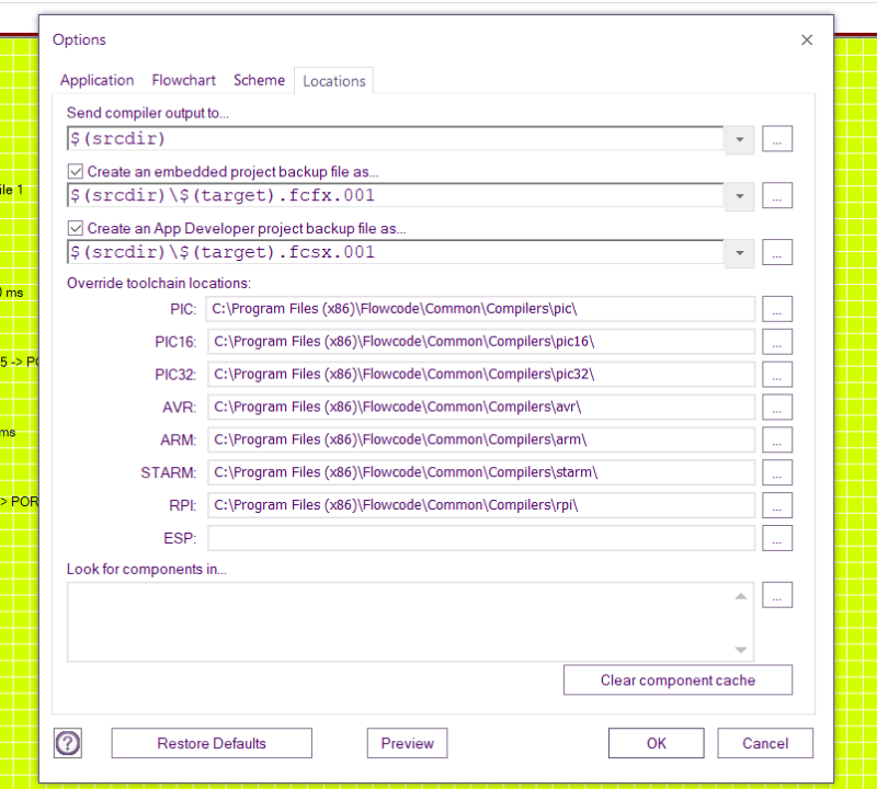

No probs with FC8, still work. But I see in the view compileroption it call Picit2 Do I have to click to EB board, and is there any risk, or shouild it do this automaticly?
Br Jorgen

I see the problem. In v8, you were using mLoader but in v9 you have chosen PICkit2. Please select "E-blocks" and make that the default in the "Compiler Options" screen.
