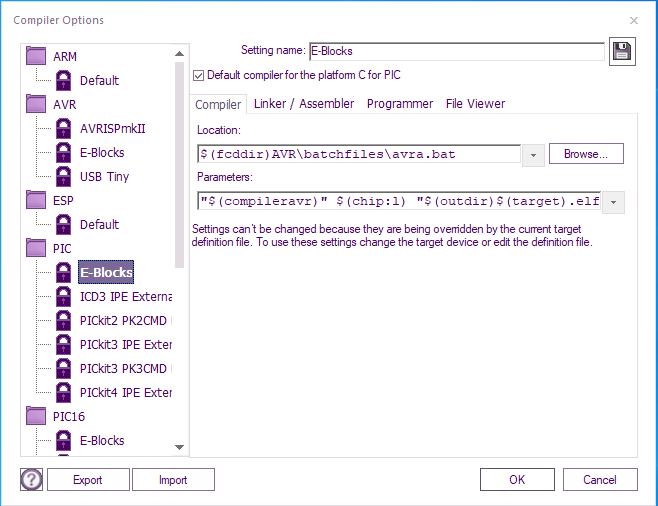

What you need to do is Select Build, Compiler Options
Select E-Blocks just under the PIC section, then make sure Default compiler for the platform C for PIC is selected.
Compiler Options.png (40.68 KiB) Viewed 3062 times
I have placed the compiler messages within the Code tags.
You can do that and load attachments by selecting Full Editor & Preview.
Highlight the code, then select the </> tag.
