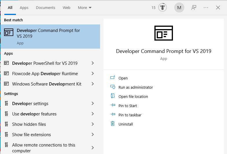

Can you check that Visual Studio Developer Tools is correctly installed?
To do that select the Start menu and type develop
If it's installed you should see: That is on my Win10 PC.
I have just checked on my windows 11 PC and I also get the Developer command prompt for VS 2019 appear on it as well.

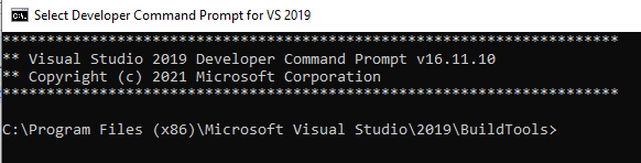

Open the Developer Command Prompt for VS 2019 and you should see: Is that what you see?
If not, then you have an issue with VS BuildTools 2019

Re: toolchain PI pico
HI medelec35
thanks for the screenshoots, they allowed me to understand where I was wrong.
Thanks again
Thanks again
hi
the problem was that i was downloading and installing visual studio community not build tools
thanks
thanks
