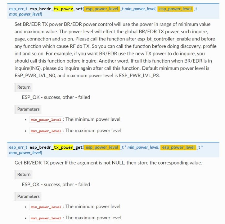

For the Bluetooth Classic BR/EDR it's possible to set the transmit power Level
mostly the transmission power can be adjusted in few steps dbm like
0dbm
+4dbm
+20dbm
With this setting you can set the distance range and the power requirement.
In my project I only need a few centimeters but I have a small battery available
Can I use commans to set or read like in this doku with flowcode?
https://docs.espressif.com/projects/esp ... ower_level

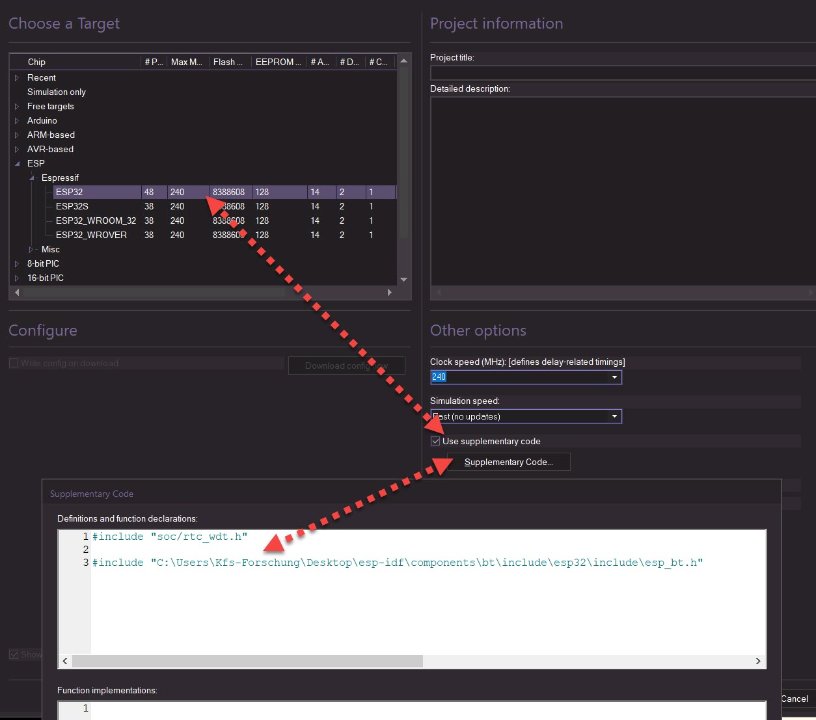

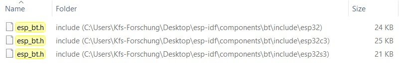

I found 3 of this file and I included one of them (I have a ESP32 Pico)
No Error
#include "C:\Users\Kfs-Forschung\Desktop\esp-idf\components\bt\include\esp32\include\esp_bt.h"
I also build a variable ESP_ERR_ T (byte) and add the C code in my program. But now Error on compiling...

Hi Martin, Hi Leigh
I've tried many things but as soon as I activate the C code I can't compile anymore.
And I also suspect the path for the additional code would have to be shorter than what I did.

I did the same for my program for the BT command
Also my command for BT Power dont give errors anymore.
But the power with bluetooth sending dont change even if I set to min or max power.
I'll see what else I need to do then additionally so the powermode will work.
esp_bredr_tx_power_set(ESP_PWR_LVL_N12,ESP_PWR_LVL_N9);
esp_bredr_tx_power_set(ESP_PWR_LVL_P6,ESP_PWR_LVL_P9);

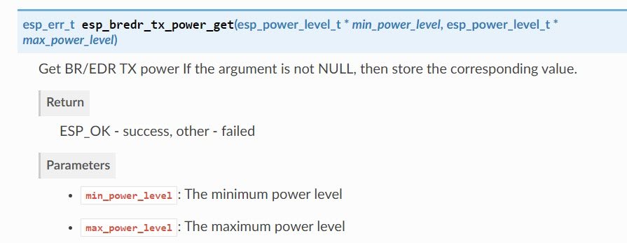

Can you also give me an example of how I can read values from ESP32 with FC9 "C command"?
Like this get command..
esp_err_tesp_bredr_tx_power_get(esp_power_level_t *min_power_level, esp_power_level_t *max_power_level)
https://docs.espressif.com/projects/esp ... _vhci.html
Posts: 2334
Has thanked: 647 times
Been thanked: 856 times
Re: ESP32 How to set Power Level Bluetooth Classic BR/EDR
The C code for that might look like this. You can use a Flowcode Byte variables min and max to take the values in a more normal numeric format you can work with.
esp_power_level_t esp_min, esp_max;
esp_bredr_tx_power_get(*esp_min, *esp_max);
FCV_MIN = (unsigned char) esp_min;
FCV_MAX = (unsigned char) esp_max;

As soon as I use the get command I always get an error no matter what I try
