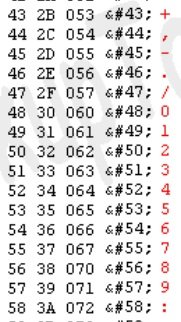

The Calibri Black Number and Fixed Number fonts include ASCII 43 to ASCII 58 and so should allow you , and . characters, looks like it's just the Verdana Number font that's more limited at ASCII 48 to ASCII 58.
I'll have a look and see how easy it would be to add the extra characters
Posts: 2334
Has thanked: 647 times
Been thanked: 856 times
Re: Floats as "number font" on display
I've had a go and pushed a new version of the font component to the library update system, hopefully Verdana Number should now have all the characters shown above to match the other Number fonts.
