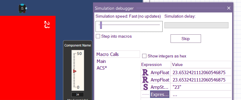

Hi!
If I try to print a number (float) in the display I do not get any digit after the komma
The same if I try to convert from float to String and print the string.
same result if I read out the value Intgr and convert to string.
It work in LCD display.
Is there another way, please?
Br Jorgen

The code in your "AMPS" macro appears to be working and the "Amps" float variable is correctly being converted to a string and being displayed on the LCD. But this macro is never called in your program.
If you run the "AMPS" macro directly (using the dropdown underneath the "run/go" button then you will see this macro working correctly.

Have made some small changes for you.
If you convert an integer to a string there will only be whole numbers.
The format you need is MyString = FloatToString$ (MyFloat,x)
Where x = required number of decimal places.

Hi Martin and Steve!
Ohh yes, now I see the ligth, and it work. Again thank´s to you both :D
