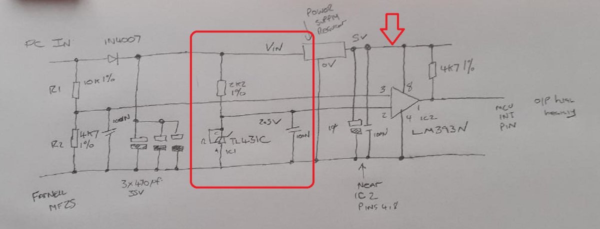

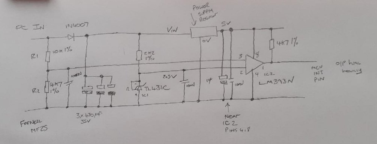

Afternoon All,
Following another post on here that needed to know a low power supply voltage and trigger an event.
This got me thinking .....
I came up with this circuit - please see attached
The incoming supply DC voltage 7 - 9 V DC is monitored and if low the comparator output goes low, this could then be connected to an Interrupt pin on the micro and used to trigger a "Event"
The 3 x 470 uF Capacitors hold up the supply hopefully long enough to the "Event" to take place
This is only a rough and ready test circuit R1 & R2 possibly need looking at at the output went low when the DC input voltage was at around 4.9 V DC
Hope somebody finds this useful
Steve

Re: Power Supply Monitoring Circuit
Noticed last night if anybody wanting to have a go with this i have put the voltage reference in the wrong place
I would normally place it after the voltage regulator
The circuit works on a bread board as described above, R1 & R2 may need adjusting experience shows that voltage dividers on breadboards tend to give incorrect results due to the connections resistance.
I plan to have a further look at this circuit later and draw it up properly.
Steve
Edit : Change the 2K2 resistor on the TL431C to 390 Ohms when powered from the 5 Volt Rail
The Resistors i used are MF25 Series From Farnell
Steve
Hi Viktor
What do you want it to do / measure ?
The circuit works by comparing 2 x 2.5 volt signals. Vref from the voltage reference and the voltage divider network.
If the non-inverting (+) input is greater than the inverting (-) input the output will be high.
If the inverting input (-) is greater than the non-inverting (+), the output will be low.
I originally made a mistake and put the TL431 before the voltage regulator, this should be after the regulator ideally.
:edit
In normal operation the output is high.
Its not desirable to have circuits energising on faults.
Steve
:edit
Steve

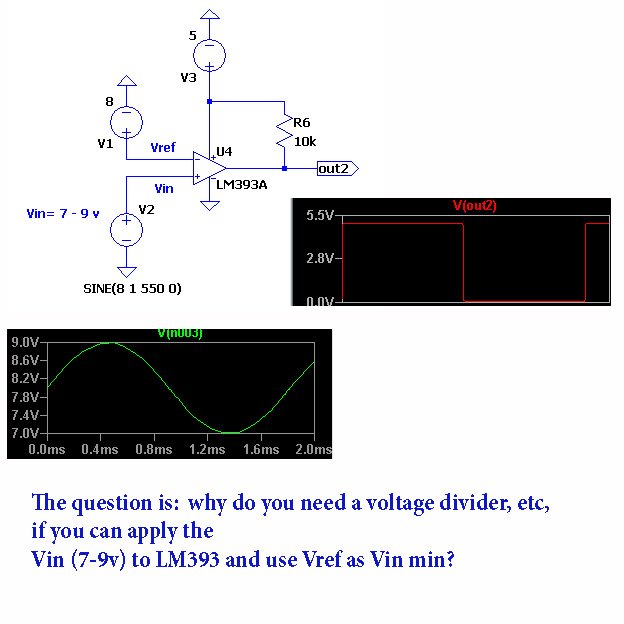

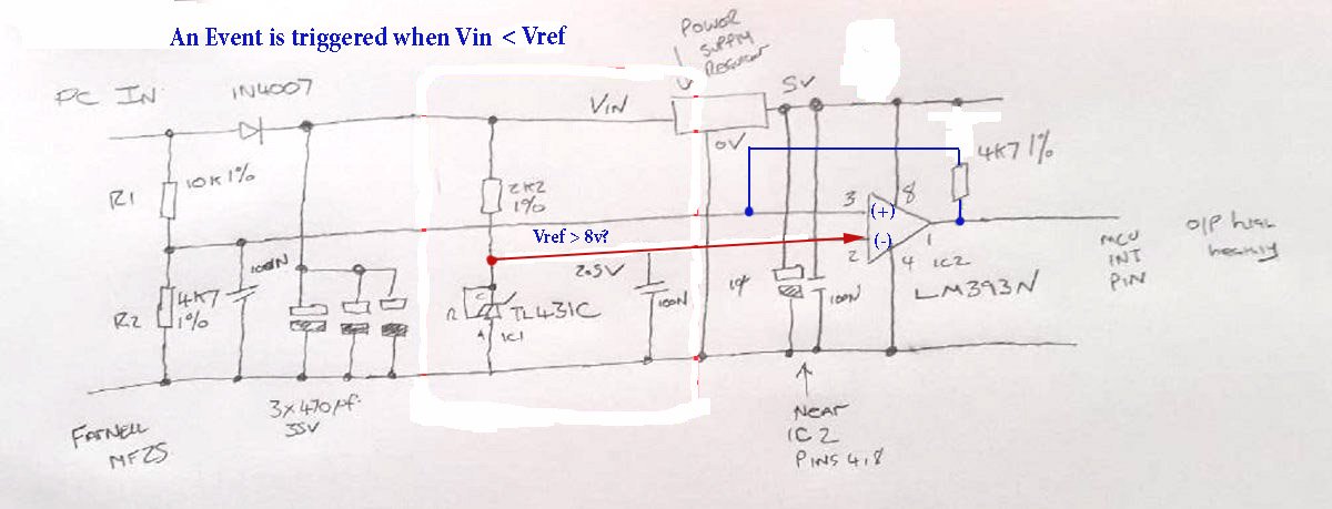

Hello Steve, ChipFryer
Re:The circuit works by comparing 2 x 2.5 volt signals. Vref from the voltage reference and the voltage divider network.
- Event_trigger_1.jpg (71.95 KiB) Viewed 4919 times
Morning Viktor,
The circuit arrangement is a common arrangement that i used to employ on some battery monitoring boards for deep discharge protection.
This voltage is any where from 48 to 254 V DC this is where the voltage divider came from.
I just used the same input method for ease as i took the supply voltage to 15 Volts (see above tables) and altered the voltage divider to suit.
Steve
Edit:
just replied quickly previously, and didn't give it much thought.
Using a voltage divider allows you to better control the operating point of the comparator by setting the divider network to suit your voltage.
Steve
Edit:
