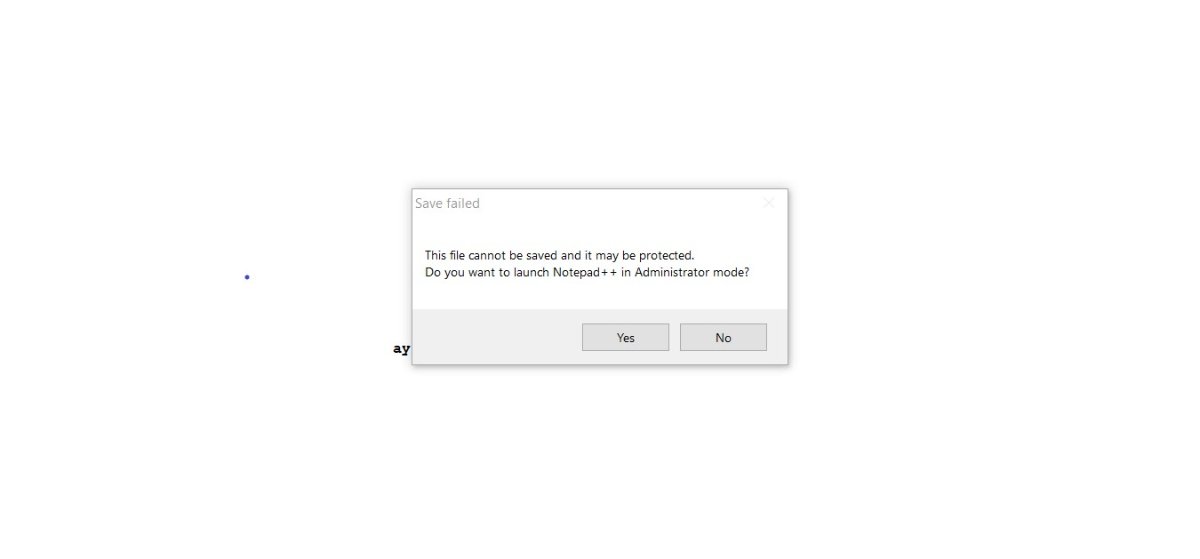

I do not know if it is possible to fix this problem, it could be a windows thing.
If I edit a web page (using Notepad++) and then simulate it, run the Flowcode project and then the web page all works fine.
If I then decide to edit the page I get the following warning that it cannot be saved as it may be protected. Stopping the simulation is not enough or closing the open file. I have to close Flowcode completely which is annoying to say the least. Is there anything that can be done to stop this happening.

Hi Bob,
Aha yes I know what this is likely to be, I've just pushed a change to the library system that should hopefully solve this issue for you.

Hi Ben,
I have just tried a library update (full database) and it says I am up to date?

Hi Bob,
Aha I fixed it in v10, are you using v9?
I'll get it sorted in v9 for you too.

Hi Ben,
I am using V9 currently but plan to go to V10, probably at the end of the month when I get paid again. (thats the problem when you take early retirement).

Hi Ben,
Thanks, it works fine, dont even have to stop the simulation.
