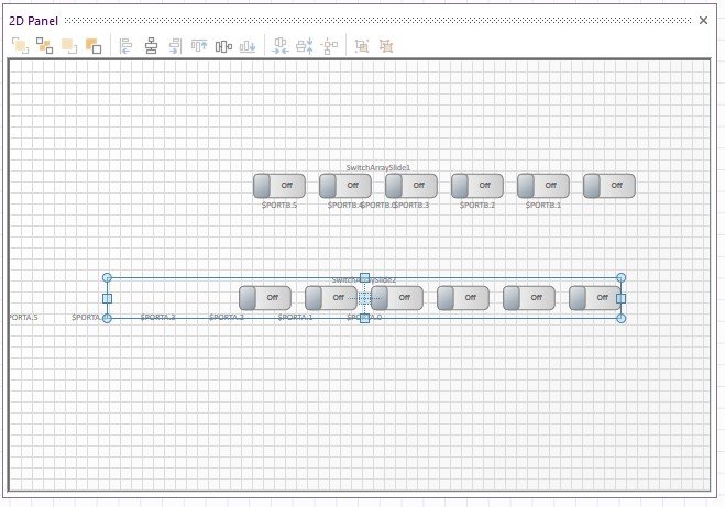

When using the Switch Array (Slide) 2D, when resizing to say 6-positions, the text screws up a bit
Switch Arrays.JPG (52.27 KiB) Viewed 3174 times

Following on from above, I was using latest FC on W8.1
I tried on my W10 machine running 10.0.0.14 and things were fine

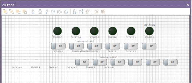

Array Slide 2D FC10-0-0-14.jpg (77.13 KiB) Viewed 3151 times
I then updated the W10 to latest (inc libraries) and the problem returned.
Array Slide 2D FC10.0.1.18.jpg (76.59 KiB) Viewed 3151 times
EDIT...
As per advice another post earlier in the week, I deleted my FC10 folder on my W8.1 forcing FC to download latest, problem persists

Further to above, once closed and reopened I can't select the array unless I click outside the switch area and "drag" a rectangle across to capture.

Thanks. I've been able to replicate some of this and we're investigating.

Hi.
Would you like to try the attached components and see if they are better for you?
Just for anyone that does not know.
If you would like to try the component before the updates are pushed.
Browse to this location using file explorer, it's hidden by default so just paste the link into your address bar.
C:\ProgramData\MatrixTSL\FlowcodeV10\Components
Replace the existing files with the attached files.
If you run any component updates, then the components you added will be overwritten
switch_array_push_2dgi.fcpx

Just tried on my W10 machine and all seems good.
Many thanks,
