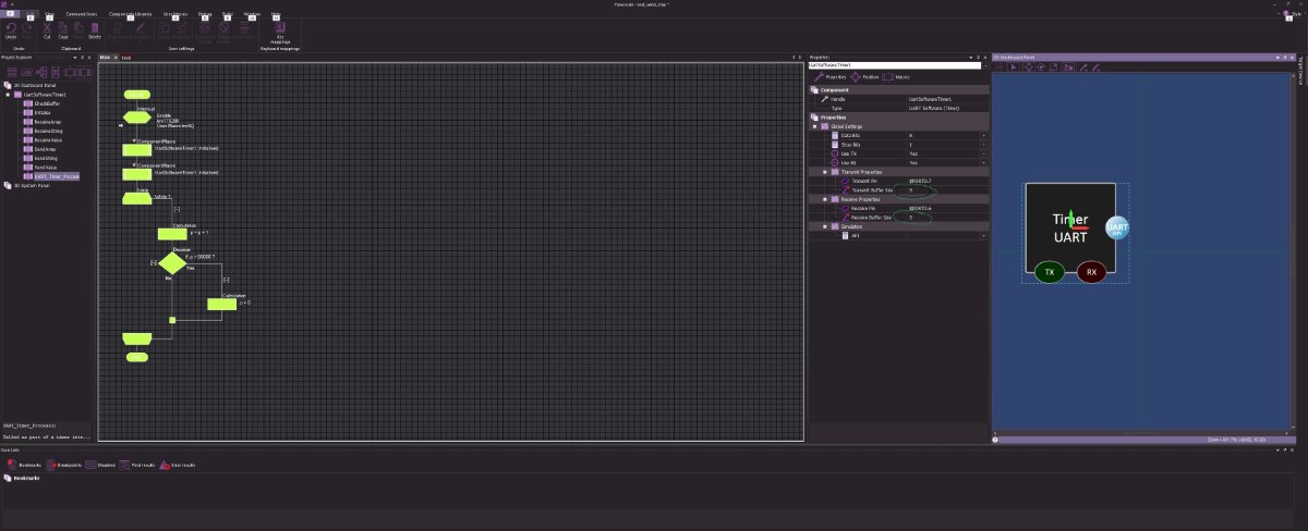

Hi Guys!
I can't seem to set up the UartSoftwareTimer component either. Transmit buffer Size and Receive buffer Size are not changed, I can't change their value. by default Transmit buffer Size and Receive buffer Size 50.
this component also does not work if you enable TX and RX
UartSoftwareTimer component FC9 Help

here is the project

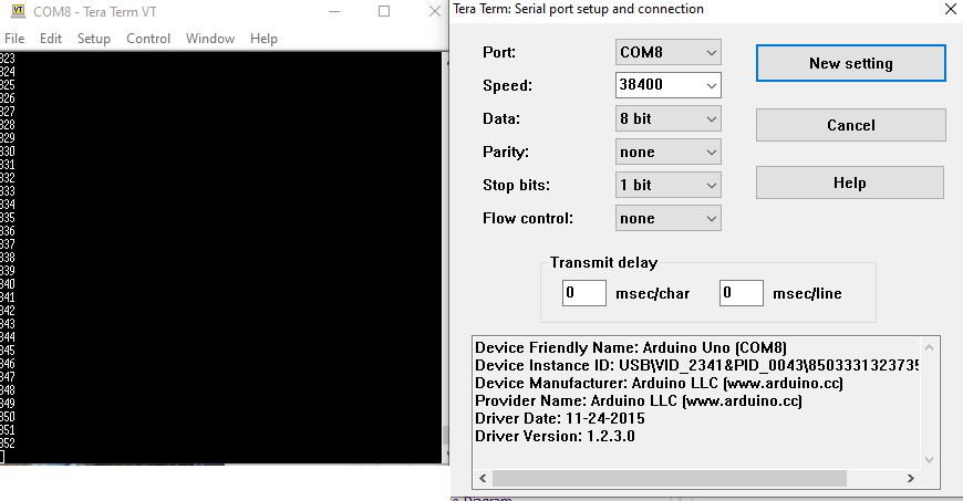

I have set up the timer UART for 38400 baud on the Arduino UNO.
As the timers are not good on AVR devices, I decided to use the Timer Interval component, to save a lot of calculation and C code within a custom interrupt.
You will need to make some adjustments to the Time Period value within the Timer Interval component. so it may be a little trial and error, but with a logic analyser it was a very quick process.
I have added instructions to the project file.
Here are the end results of incrementing a number at a baud of 38400:
