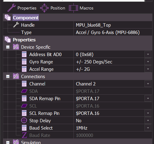

The MPU6886 is working nice with the adress 0(0x68)
But NOT with the adress 0(0x69) (and hardware change pin A0)

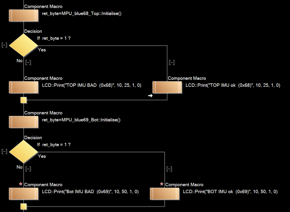

There is already a problem with initialising
This program does not run, it hangs on the second test.
no matter if address 0 or 1 first
hang on second test:

I prepared 4 IMU
2pcs with adress 0x68
2pcs with adress 0x69
I tested individually on bus1 and all of these work well.
So I connected them all on bus1 and bus2 and this is not working
but if I connect one module to bus1 and the other to bus2, it works no matter which address I use.
Only one module works on one bus!
(of course I have always adjusted the addresses and pins)
