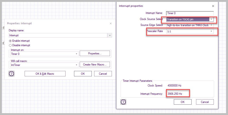

time runs very fast in the version 8 and version 9

When is it running to fast in simulation or Hardware
looking at your flowchart the Timer interrupt is set at a very fast rate may be you should do some adjustments :D

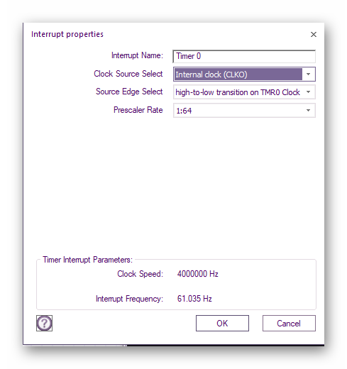

Sorry I do not know how it happened. I send the correct setting. but the result is the same. What I understand is that every clock cycle interrupt.
