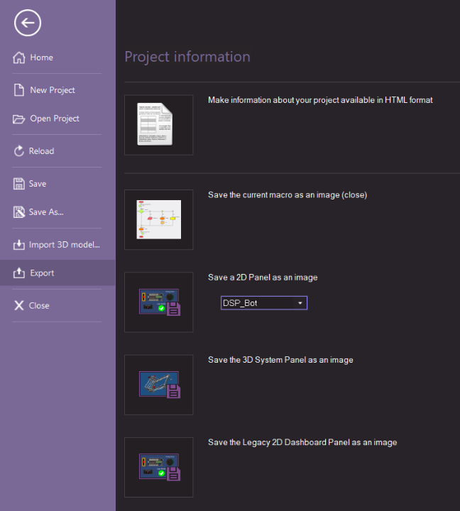

Did you see this export and more even a html doc with the charts?
- Snag_b67818.png (81.37 KiB) Viewed 8802 times

Flowcharts can be saved as a PNG, JPG or BMP. None of these are vector format. You can improve the quality of the image export by first zooming the view of the flowchart to 200% (the maximum).
Re: Print a flowchart for publication purposes
@stefan.erni, yes that works. The HTML output appears to be vector based (no pixelation when zooming) but I don't see a way to import that into Word. I need to look into that, if possible that would be ideal.
Edit: Yes that works, you can import an HTML into Word, but for some reason a FC comes across at about 60 inch x 60 inch!
Setting the size down to 10% or so makes it manageable.
You can save individual flowcharts but only as .png.
@Steve-Matrix zooming will probably not work for me as the FC already fills the screen as it is. But will look into it.
Hi Jan
if you load the HTML in Chrome, Click on the flowchart you are interested in, it will convert it to a large png. on a separate tab.
Click on the three dots on the top right of Chrome, select Print.
Within Destination, select Save as pdf.
You then have a zoomable pdf file.
